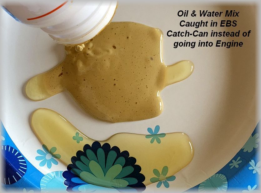

Kevin, I am collecting the debris from my catch can in a plastic bottle (small pill bottle), and if everyone could see what I have collected that would have went into the TB I would say that they would be absolutely amazed. I carry it in my tour pack and show anyone at the local dealership that shows an interest and they are quite taken back by what is going into their TB.
It is a muddy looking gooee mess with some water mixed in. The consistence is like a tan/brownish pudding. Discussting!! And believe it or not, I can feel the increased (seat of the pants) performance. It idles better, runs better and my mileage is pretty good giving that it is a high performance 120" motor. I really like the idea of having a drainable catch can on the system as well. Draws a lot of attention also since I have it mounted on my left side front down tube. This actually starts the conversation as most people want to know what that "can/filter" is for.

Hey Roger!
Can you post some pics?
If it is ok with you, I would like to use 1 of them in a technical reference article I'm doing for the new website.

Hey Roger!

Here is a pic Roger sent me (thank you) of what he drained out of his EBS catch-can.
Yes, riding habits (lots of low RPM heavy throttle, lots of high RPM) create more oil blow-by, type of oil, high heat, level of oil in tank...all these thing affect how much oil blow-by there is. Shorter trips, where the engine does not get fully heat soaked, will get more condensation mixed in with the oil.
But there is always a certain amount of oil coming out of the breather bolts (it is impossible for it not to be so), how much, and if water is mixed in, are the variables.
