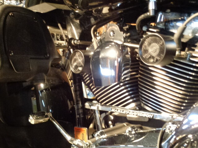

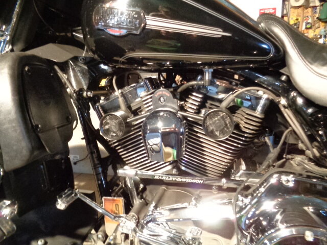

Jack I never run old Shiney without them on I have dropped 20+ degrees especially in urban areas I have never seen 265 this year even on the high 80's rubbing 90* Really wonder why I waited so long to install them. Ride safe Fred

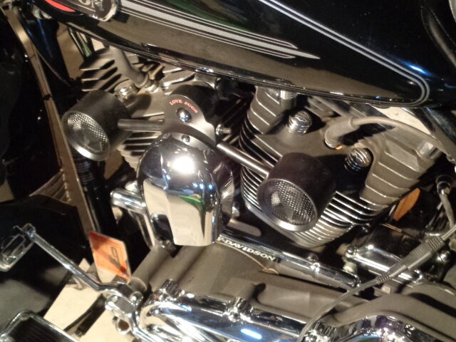

Nice Fred, I got mine up a bit higher, aiming closer to the spark plugs, Me Thinks that is the hottest part inside the heads? If not I will tweak it a bit lower like urs, What do u think?
Those are where my mount placed them it was simple bolt on I thought that is were they all fit the mount that comes with them placed them there I did no adjusting or anything like that. They seem to be working great and I feel no need to move them.
Remember I went through a period of electrical interference with the PV and the accessory circuit/switch for the fans. :Coffee:Ride safe Fred
Yup, I think I will let them be
They are working so best to let them work
The wiring to the battery sure was simple, I aint scared:laugh: The only part I did not use was the original H D horn bracket, the one that came with the Mighty mites was far superior. The instructions R very easy, the vise grips did not work too good on the rubber isolator However I have a set of stud removers that worked GREAT for off and on
