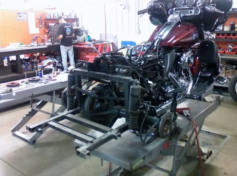

bikerbozo,if you have a trike manual,it has a section on how to adjust it.Looks like a sway bar on an automobile(kinda).Keystone,it is pretty tight up there.I have a trike lift i drive it up on & then crawl under it.
You can see it running across the rear from left to right. Like Arnie said it kind of looks like a sway bar.
Little better picture.
