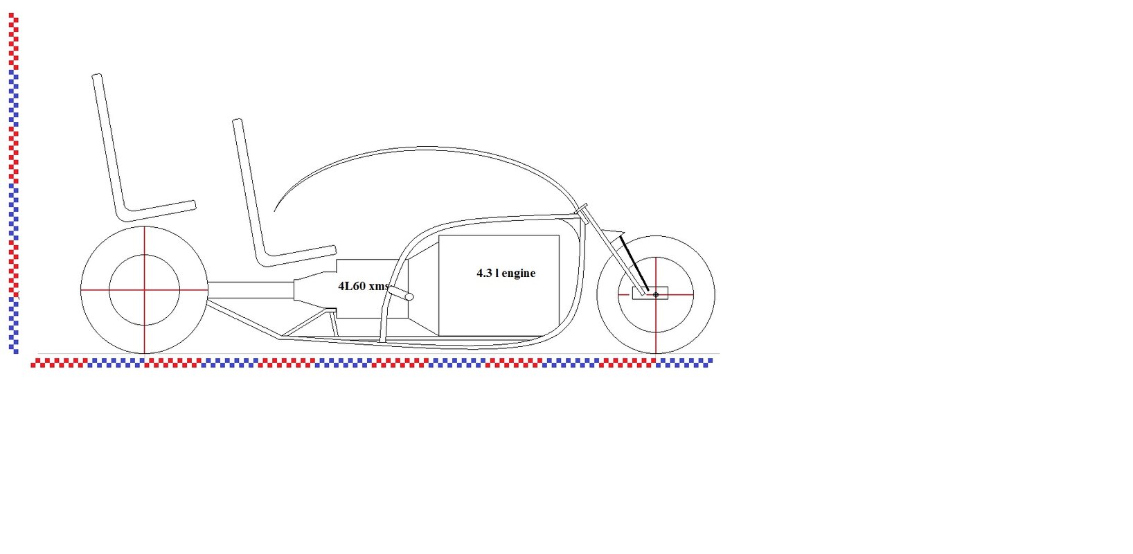

As already stated, I'm a completely green noob. Used to spend a lot of time up on 2, but due to a work injury and spinal fusion surgery, that's out of the question. Here we are a few years down the road and I'm itching to get back into the wind, so I decided I'm going to build a trike. Now, I'm the sort of anal idiot that has to have everything designed, engineered, over-thought, scrapped, re-designed, re-engineered and toyed with on paper before I ever pick up a tool and start....but once I have that design hammered out to my satisfaction, the rest is nothing but pure fun.
So, I'm looking for some design ideas from you more experienced trike builders/riders. As I know, if you ask 10 riders their opinion on something, you'll get 20 opinions....but here goes....
I'm thinking I'd like to go with a small Chevy engine, maybe a 2.2l or a 4.3 on a mid-engine trike. I'm probably going to end up raping an S10 for the engine, drive train and rear axle, then put it on a custom frame with link lead forks.
Anyone with ANY input ideas, your thoughts and comments would be greatly appreciated.
Concepts....
This is....sort of....what I have in mind. Is there anyone out there that's better at drawing?
Wheel base is 9' for reference, engine and xmsn sizes are roughly accurate. Seat backs are shown as 30" tall-ish with a 15 butt pocket.

Thanks FuzzyWuzHe! I hadn't thought that far ahead as to look into that.
Here in Michigan all the builders I know just buy an old bike with a title and use the head stock with the numbers stamped on it. They register it using the bike title and just dummy up about the "mods"on the bike. May not be right but I've yet to hear of a problem down the line.
My 2 cents
I would recommend an independent rear suspension(IRS) as I feel your pain with back injuries. I am using a rear suspension out of a Subaru WRX. My solution might not be your cup of tea, but the older I get, the more I appreciate a smooth ride.
