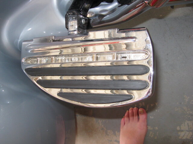

I have Kury's on my VTX. 4.5" x 9". 2" Kury offsets to move them down or forward, whichever is needed. You can also stack the offsets. Pic shows boards before I bought the very reasonable $14.95 replacement rubbers from Kury. All eight. Didn't have the offsets on for the pic.
