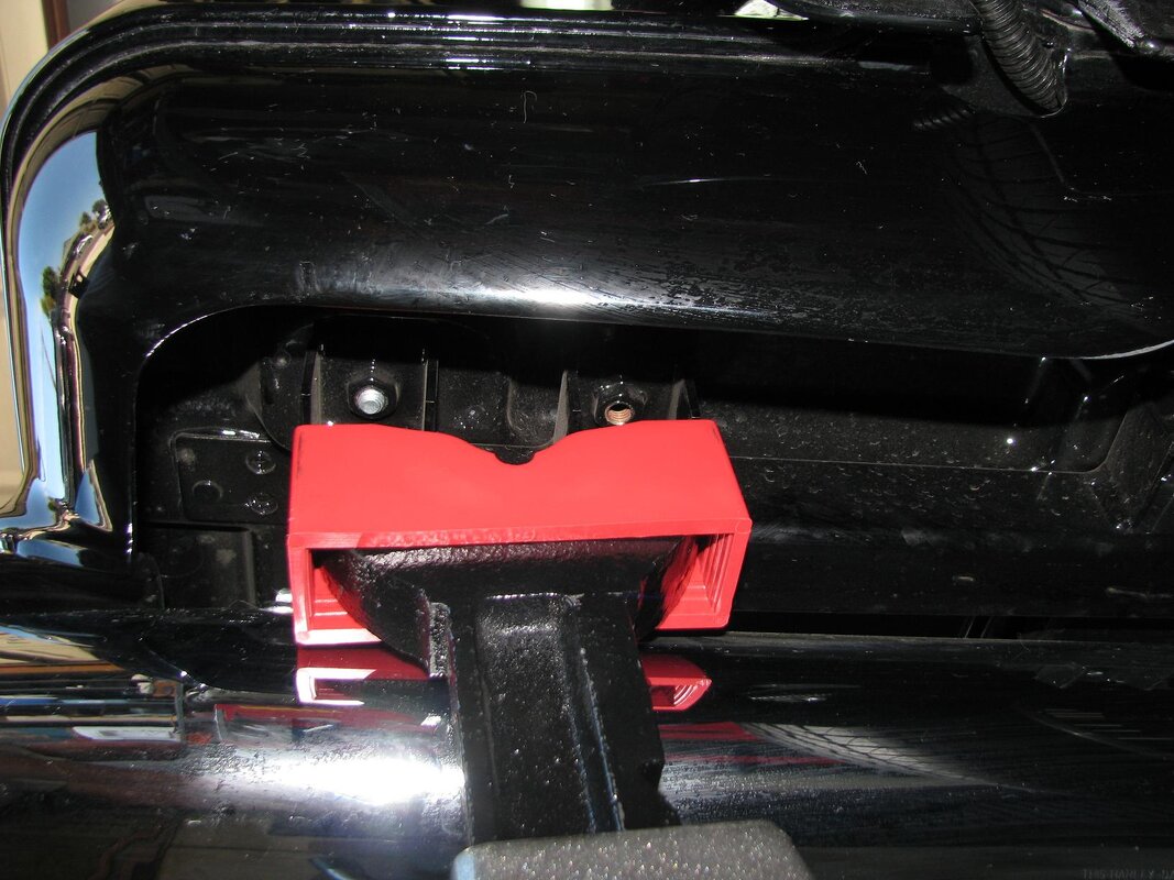

Here is how I use to jack up my Trike.. Others use a floor jack and jack stands..

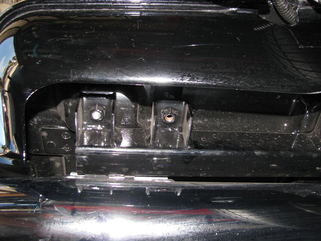

Is this the right location to drop down and safely support the rear of the Trike on jack stands?
That is exactely where I put the jackstands. I did use the ones that are furthest forward...Dave
Hey trikemutha ,,, Did you make that adaptor ?? How tall is it ?? And how wide ?? Did you bolt it to the jack ?? I like it and can make it if I know a few Dimensions..Thanks Dave
Nope bought it from pitbull jacks..It has a lip that slides and holds on to the lip of the jack .. Don't have dimensions as I have to find the adapter plate..I don't use it much these days ..
