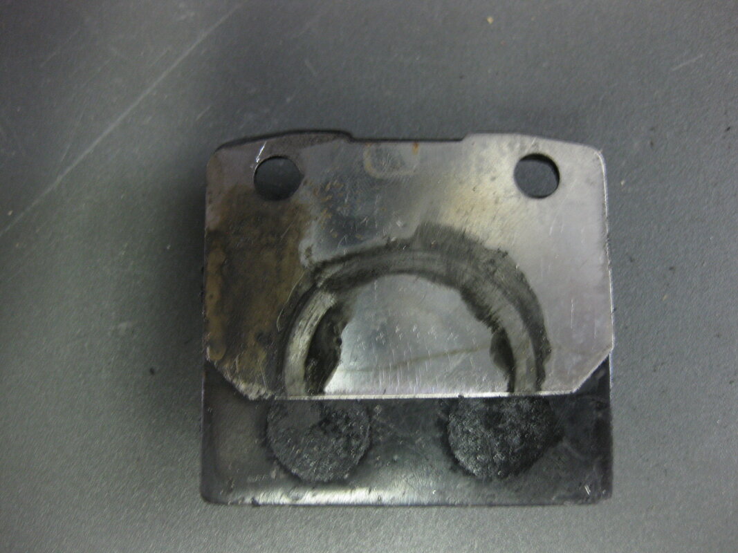

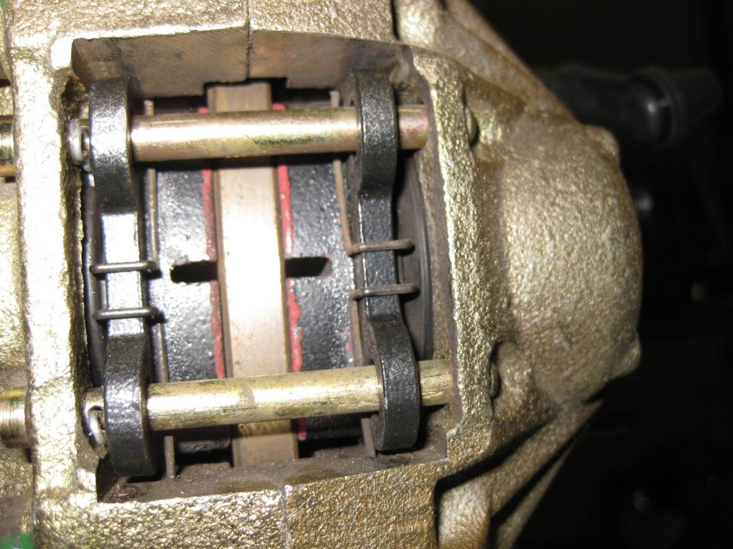

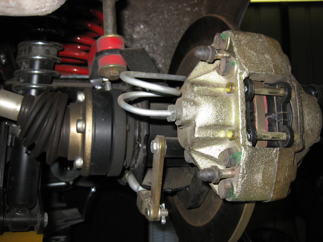

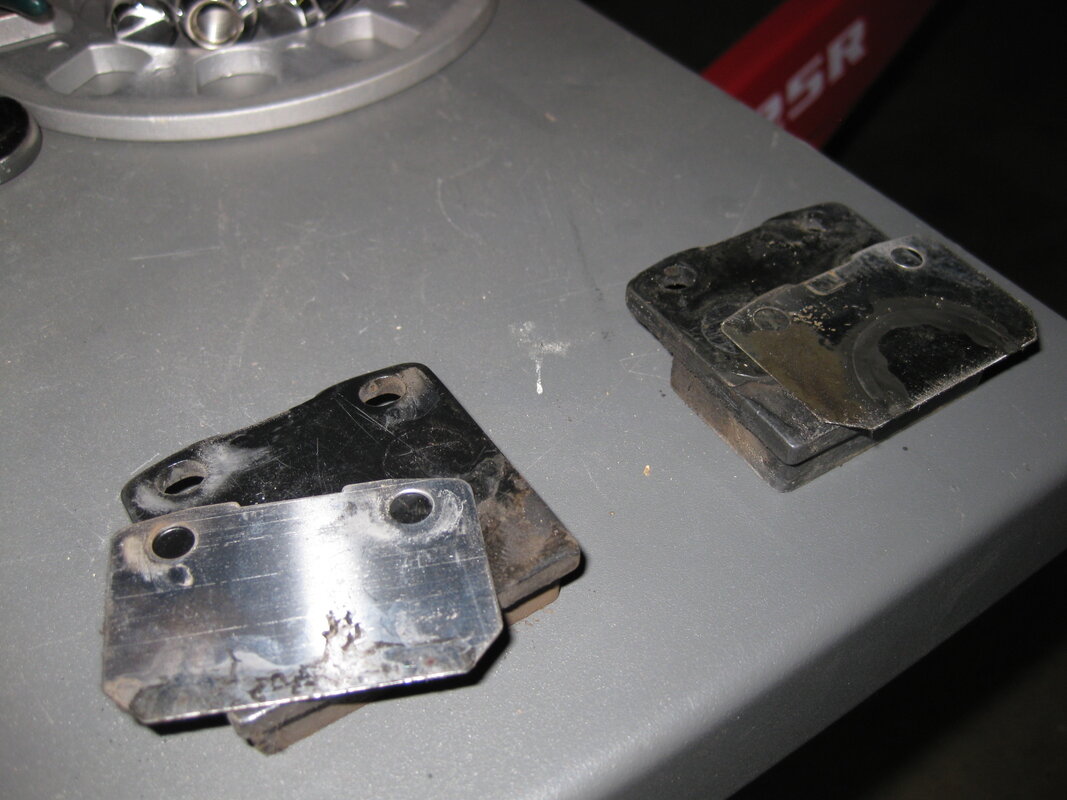

For you Roadsmith guys having trouble with braking on the rear, Roadsmith a few years back changed to EBC YellowStuff brake pads that where true EBC Pads, Taylor sent me a set to try and when I received them they where slightly longer and had the shim made on the pad so everything pushed down evenly, the pads that came on my kit where pushing cockeyed and not flat (see Photos) So to maximize their performance I went to the EBC site for Yellow Stuff Breakin procedures, http://ebcbrakes.com/articles/how-to-bed-in-your-new-brakes-for-streeturban-driving-2/ , and I removed the old pads which were glazed from not riding flat and took some 200 Grit sandcloth and skuffed the rotors to remove the glaze.
The new EBC pads come with a breakin coating that will help in the wear / breakin time it takes but you must break them in correctly. New brake pads are not pre-broke in and some do not use the coating, but done correctly and blead correctly you can lock these brakes at will... I was a Road Racer in my younger years and lived on the front brakes and breaking the rear loose guite often. Now I am the opposite and use the rear 90 - 95% and really only use the front in an emergency, panic stops, or at a traffic light to hold the trike. I know that the DP-4105R EBC Yellowstuff are the same as the DB15 - D30A - or the VW #311-698-151B pads that fit the #311-615-107 & 108 VW Calipers used on Roadsmith and quite a few Champion Trikes.
So life without linked brakes for me has no bearing / and it shouldn't for anyone as long as the parts used in your kit are setup correctly. Then its only breakin and becoming familiar with how they work. But please remember once your brakes are setup correctly you have to use them and at times with no one around use then hard to keep the glaze off and from building up. Again read breakin proceedure and learn how or find someone who is skillful at brake bleeding... take you time and have plenty of fluid on hand to keep your reservoir full.

Pad removal is very simple for the Roadsmith calipers, there are 2 Large pins going thru each top side of the pads and there a (2) smaller pin-clips to remove / first place a larger screwdriver between the pad on one side and pry slowly against the rotor until the hub spins freely, now remove the small clip pins with needle nose pliers, next use a pin punch and litely tap out the larger pins... done / reverse to put back together after you skuff the rotor... then to the next side... 45 minutes tops for both sides, a little longer if you need to bleed and flush brake fluid. Click on the caliber for a larger view to see the small clips... don't loose them....

I had a RS GL1500 conversion. The conversion de-links the brakes. The brake lines came from the same place so only one front rotor/caliper were used making wear uneven. The rear pads were pathetic with no stopping power and RS sent me a set of replacements which cured this issue. I assume they are no longer using the inferior pads. They are super easy to change as has been noted.
