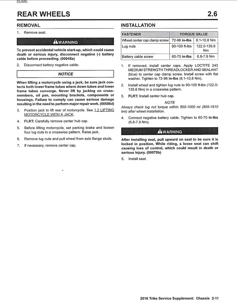

For anyone interested, here's a page from my 2016 Trike Supplement on Torque Values for Rear Wheels. Although the Note says check torque within 500-1000 miles after wheel installation, I actually recheck within 50 miles as mentioned earlier. Since the accidents earlier this year, I set up a Quarterly Wheel Torque Schedule on my Tablets Calendar. So far, have had only one lug nut on left wheel that was less than the torque value set.
Thanks ShapeShifter! I got the basic info from Jack but this is good to have. I ordered the service manuals but they're caught up in HD's parts system upgrade fiasco so no telling when I'll have 'em.
