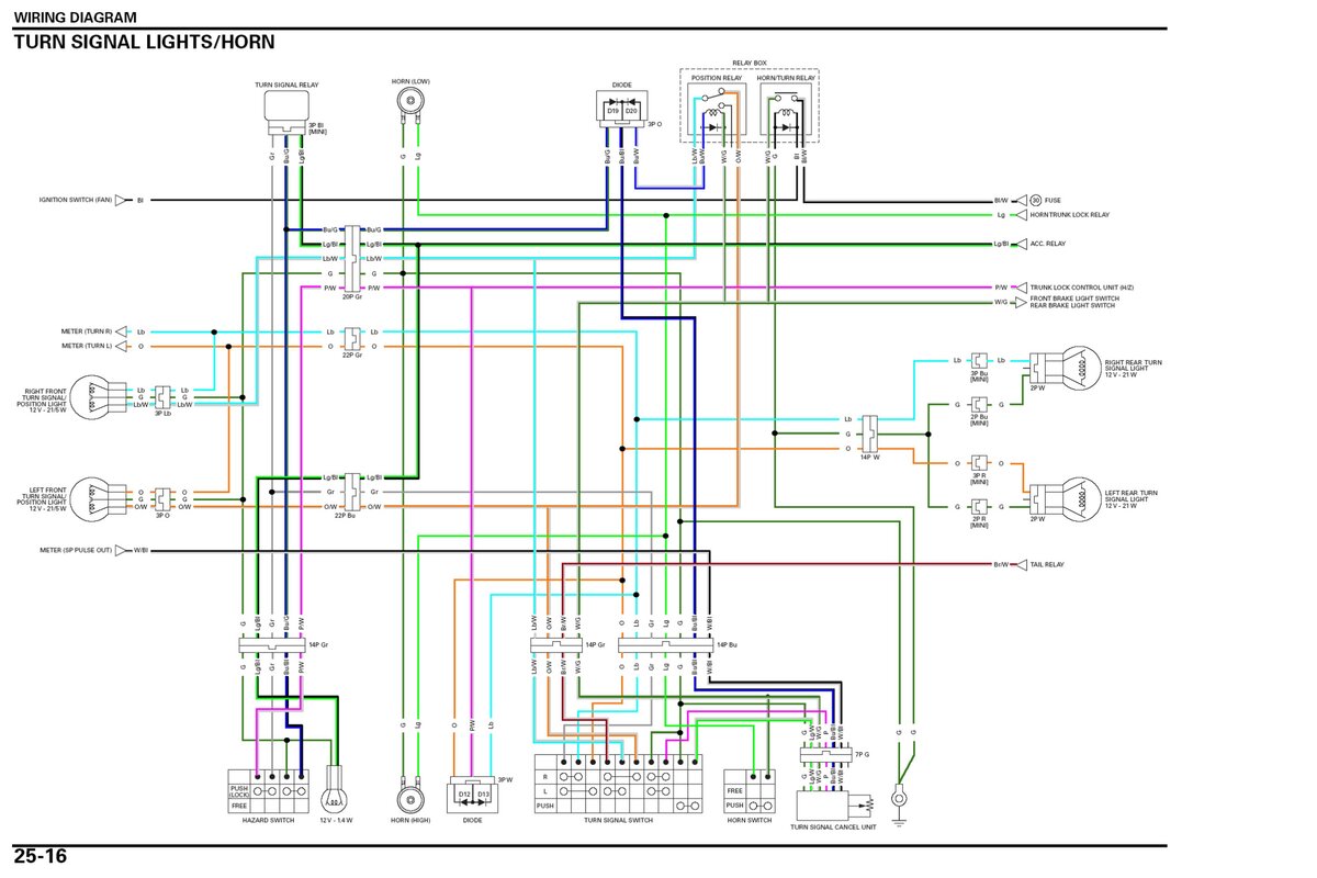

Are you saying your front and rear directional lights were all blinking bright and at the correct rate? If that is so then looking at the wiring diagram I'd say you have a problem in the combination meter assembly. Either a bad ground or as mentioned possible a bad bulb or connection. Here is the diagram just in case you done' have one.

I made a copy of the diagram, I looked at the flashers again this morning, and all are flashing (directionals) like they are supposed too...
I also had a friend ride behind me, and I used the directionals and his reply was that all was well, and both sides were blinking correctly...BUT still my left light on dash was still flashing much faster then the right... Tonight (when dark) I will check again, just to be sure... time to pull out my meter, and check wattage to each bulb...Yesterday I changed out the low beam headlight (burnt out) and while I was working on the bike I did check out all the fuses.. (all were good/did continuity, test on each fuse just to be sure ...)

That is how I understood your first post Ronnie.
Man it sure sounds like an issue within the combination meter assembly or a ground to it. Since is one effects the one directional light I suspect the light itself but that's just a guess. Have never heard of this problem in all the years I've worked on GL1800s. It's going to be very time consuming and will take some hunting around on this one. I don't even know if those bulbs are replaceable. :xszpv: :xszpv:
