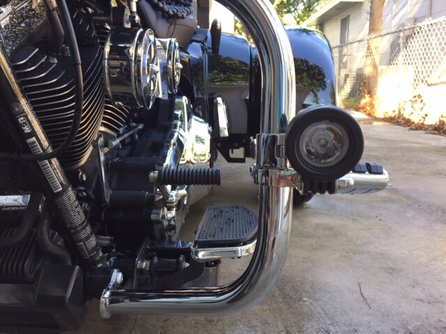

If you don't have a radio, then LED's are fine. I put one in my TG, which has a radio. 1st, needed a slightly different metal holder for it. Also, lots of radio interference. First time came by itself. Returned to mfg who replaced with model with adaptor filter cable. Worked so so. What helped was a double layer of aluminum foil on inside of lamp holder. Same as used to keep the aliens from beaming their evil thoughts to you. It is a nice bright beam of light.
