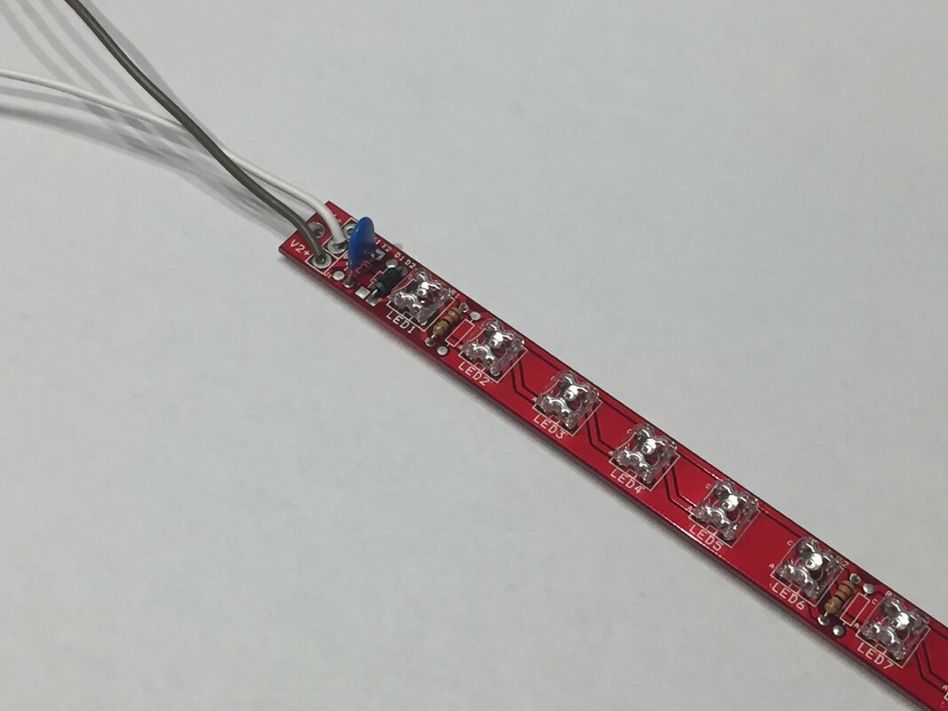

Early last year unknown to us we received a few boards from our supplier with a bad component. They are mixed in with the good boards and are impossible to distinguish from the bad. They will even test as good and do not fail until they have been in use for many hours. These have been replaced by a newer version see picture below.
If you look at the upper left portion of the picture you will see that there is a round blue component. This indicates that it is the latest and greatest version. In every other way it looks exactly like the earlier version and they are made by the same supplier. These were delivered to us early this year.
If you have a failure with your light bar you will receive this new version as a replacement. As far as I know we have not had any of these fail.
What we can offer is to extend the warranty on these lights to 5 years. If your kit is 5 years old or newer we will replace the parts for free.
I hope this helps, and if you order these please mention Trike Talk.
