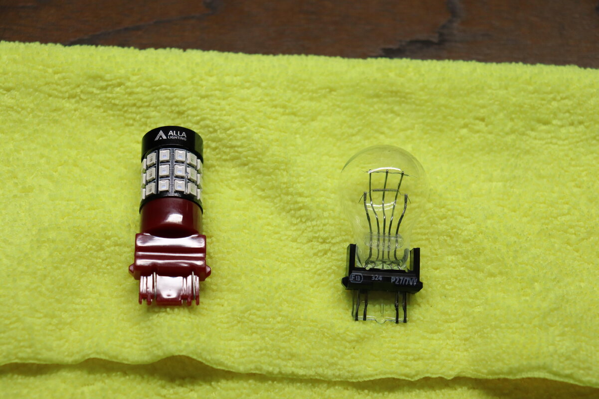

I’m a sucker for new gizmos, thingys and doo-dads. After looking over the previous comments in this thread on LED tail lights I ordered the ALLA Lighting red LEDs. They’re definitely brighter and do have a distinct signal when using the turn signals. As mentioned before, the stop signal does flash three times before going solid. Pretty nifty. Thanks for all the hints. I’ll keep the old bulbs wrapped up inside my tool bag. Never know when they might be needed!
