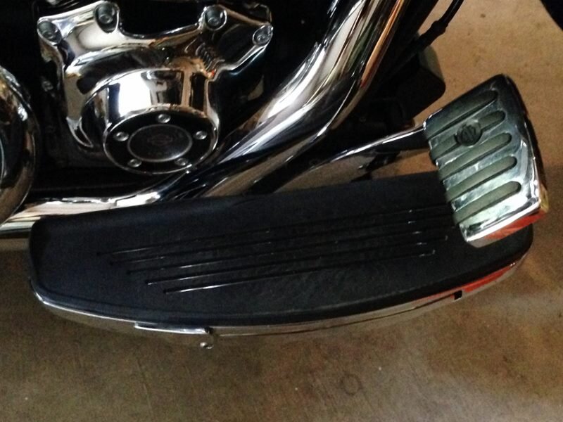

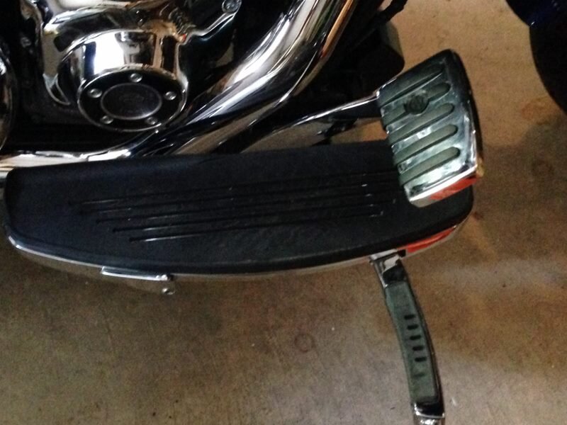

I just got these from Dennis Kirk for a good price. They are longer than stock so you must use the 1 1/4" forward position to be able to use the parking brake. It is where I was going to put them any way. They also have the issue of not laying flat that other reviewers have pointed out. I will grind the stops some to make them flat. Also these boards sit higher than the stock floor boards. Simple bolt on and ride. You can also move the floor boards out 3/4" for those that need to for heat and such. Just move the outside lever back and the cruiser pegs flip open. Use your heel to lock them back in.
