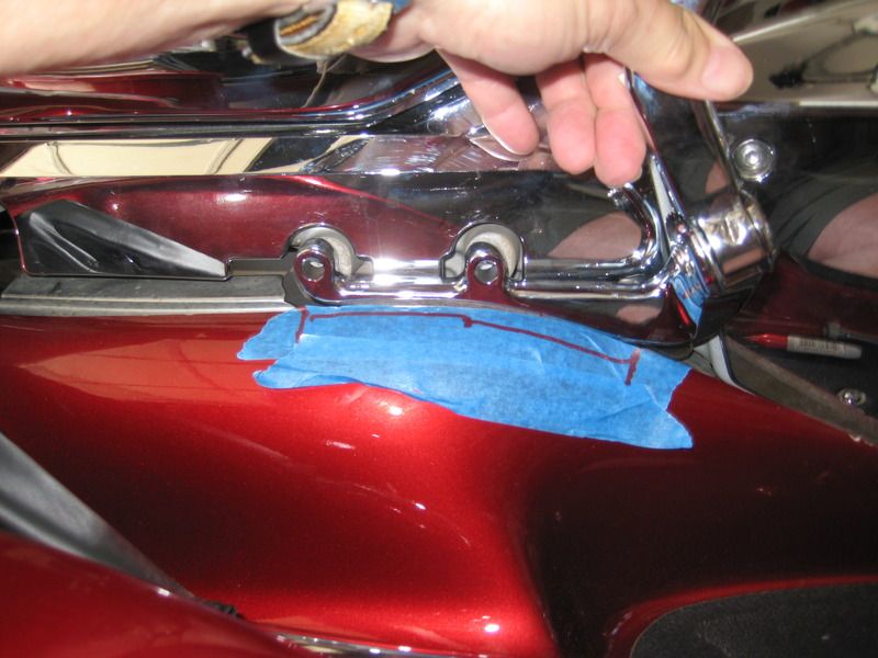

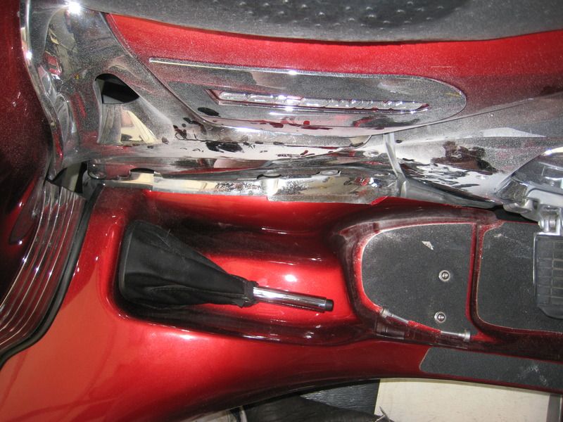

OK, here is the the (my) solution. The squeamish may want to look away !:AGGHH:

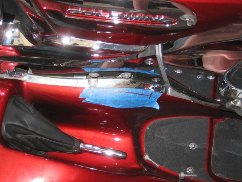

I checked how much trimming was needed on the fiberglass. It's not much - maybe 3/8" in the front tapering to a 1/4" in the rear - but you can't get the lower part of the Kury mounts on without taking some off.
I measured the area and outlined the area that needed to be removed. Don't worry about the crooked looking line - I was just getting the actual profile of the lower mount. I straightened it out before cutting.

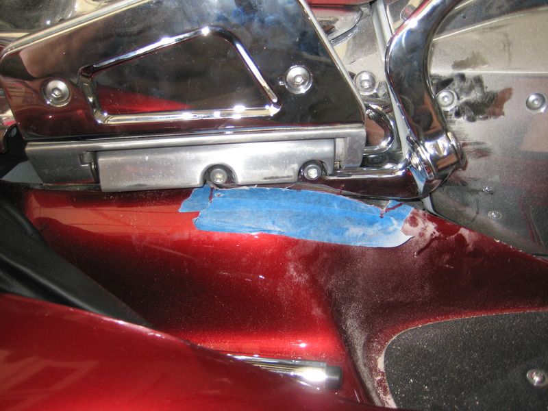

I used a Dremel with a cutoff wheel and it worked great with the fiberglass. By the way - hats off to Roadsmith ! The glass was VERY thick even up to the edge.
Here is a look at what needs to be trimmed.
Let the trimming begin ! You can see the trimmed part on the blanket.

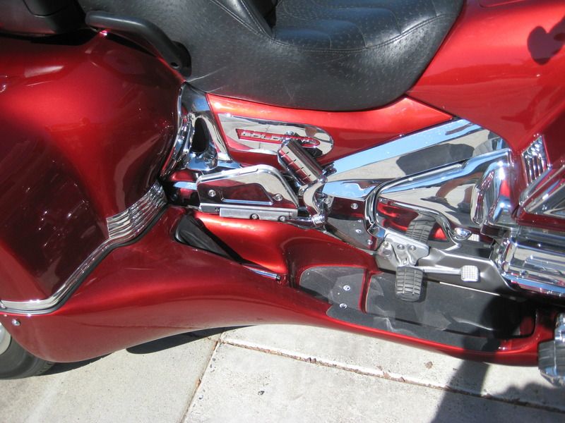

It fit in perfectly.
Not much trimmed away
Done and done. I am going to radius the edges a bit - but that's just me. I was worried about burning the paint at the cut but I didn't even have to touch up anything. The cuts were made vertically so there is not visible edge of the cuts.
I'm happy, my wife beside herself now that she has "her" pegs on the new beast.
It was an hour job start to finish on the first side and maybe 20 minutes on the second - after the fear of the first cut goes way it's a snap.
