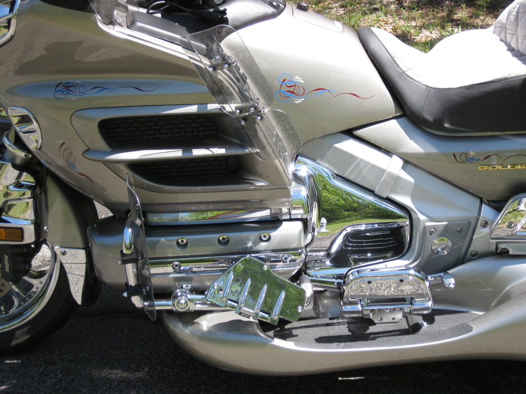

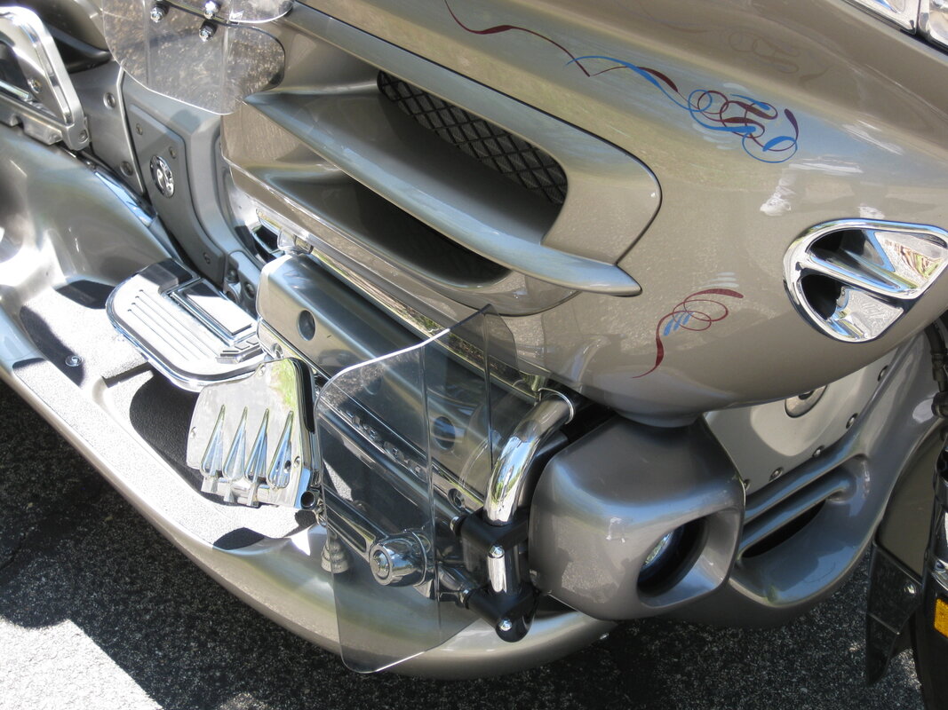

As I recall, when I installed mine....there was not as much clearance on the left side as there was on the right but did have enough room for the install
If I remember correctly like Scarecrow said, I found an area where it was barely wide enough an slide it over to where I wanted to tighten it down.... I used a mini board but the same brackets. Not very close pictures sorry....
I may have even loosen up the front crash bar to gain more access..... once it was on and started I made sure when the bar was re-tightened it wasn't touching.... mines a 2003

I would not have thought so either but when I installed those mini boards (AS A BIKE) I thought maybe something had been put on at the factory wrong.. but nope all the holes lined up just needed to be loosened so they would wiggle a little... and that did the trick!! Never thought about it again..... I was done !!
