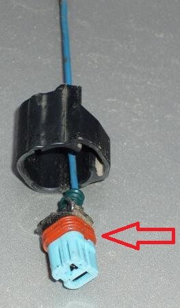

You have to remove parts to get to the 1p connector
It's usually a tab to push down on and pull off. The circled piece is holding it in place and then once tab is lifted on the connector pull down, odds are there is a seal inside to keep water out. Red arrow point to seal.

Thanks Trike Lady! I will send this info to him. I don't know for sure if he has a manual or not. He has removed the tupperware to get to the sensor.

Tell him not to pull on the wire. It is a shielded wire. As other have said, he must release the lock point on the connector, and then pull the connector down.
Tricks: to loosen contamination between the connector and the sensor, try pushing up on the connector, and also spray it with BrakeClean (red can). If the lock point is pushed, after spraying it with BrakeClean, it should come off easily.
The crew has U covered here good
I would add to lube the terminals and the locking tabs and plastic shoulders in Trike ladys pics JMO

This pic shows another view of a weather pak connector found on many vehicles up to and including ur trike, I hope this helps also
