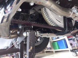

Now, on the 2019, the jack will not roll under the frame. There is no clearance anywhere around the frame, exhaust or tire for the jack to fit at all on either side. I tried calling J&S on Saturday, but no answer. I just had everything laid out to do my 1k service when I found that the jack would not work. I'll call J&S on Monday to find out what is going on.

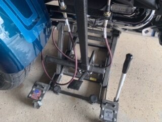

Trike is on the lift and covered. Here are two pics.
View attachment 84020View attachment 84021
Not sure what is going on with J & S jacks now, I have read they have new owners and I see your jack is going in on the right (front brake) side, that is the way my went on the 2016 but I bought a 2018 and I had to buy the conversion for my 2018, no big deal, now goes in on left (clutch) side, sure wish J & S would update their website and be a little more info than what they have, have heard very hard to get ahold of them to discuss problems, oh well mine works just fine so far, knock on wood. My bottle jack has a round knob to turn which is very nice.

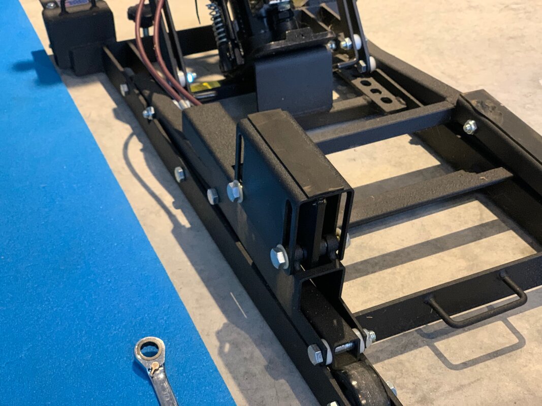

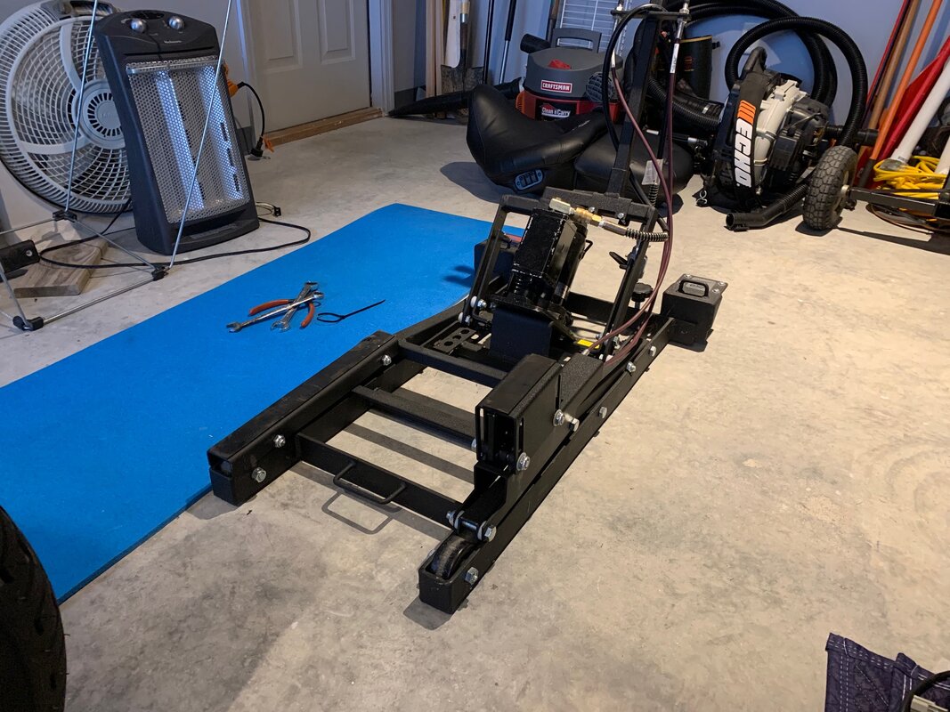

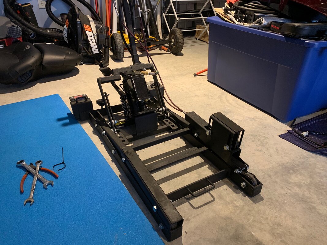

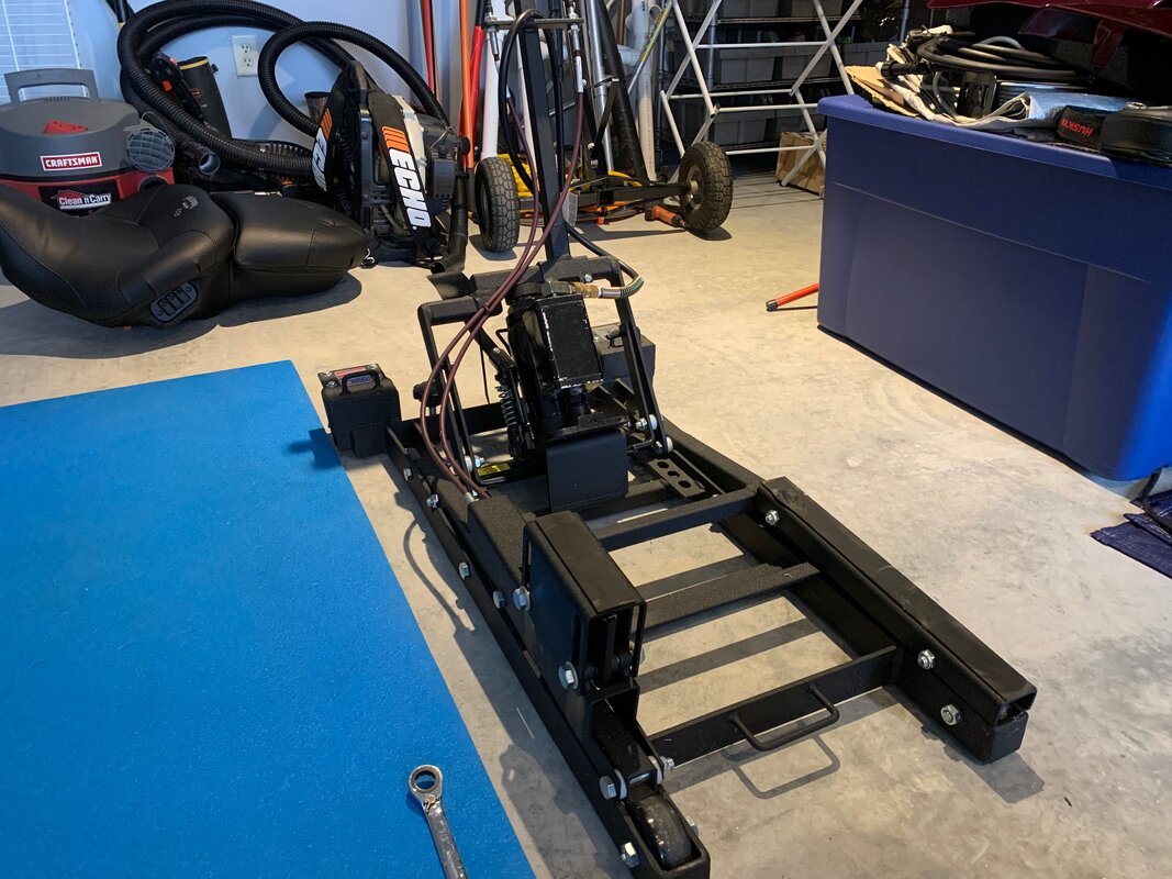

J&S Pics
These pictures are the before and after pictures of my J&S "new style" jack I received in December of 2016. As viewed from the rear of the jack, two of the pics show the jack with the riser mounted on the right side (the way it came when shipped to me) , and two showing it mounted on the left side after I swapped them.
According to J&S I can use the jack from either side. I have used it numerous times from the LEFT side of the trike but I haven't had time to try it from the RIGHT side of the trike since swapping them yesterday. However, it sure looks like it will work fine.
Not Really
Sounds like a pain in the ass no matter what year jack or trike that you have
Well it took me about 10-15 minutes to take 4 bolts and nuts apart, swap sides with the riser and reinstall the bolts and nuts. Since I wanted to use the jack from the right side of the trike, I probably will never have to swap sides again. But if I do, 10-15 minutes is no problem to me. I guess it depends on your definition of "pain in the ass". :D I like this jack.
I know my jack when first purchase the riser was on the left side if standing behind the jack, so when I got my 2018 got the conversion kit and now it is on the right side if standing behind the jack, works for me but now I'm wishing I would have tried jacking the 2018 up before I got the conversion, sounds like maybe I didn't need it, I'll never know I guess, happy with it the way it is, not sure when I bought the jack, it could be the old model before they changed design, who knows, sounds to me from what I have seen here in these posts J & S doesn't know what they are doing so to speak, some have the riser on left side and some on right and these are newer bikes and they are working, I just know I'm happy with mine and my bottle jack has the round knob to tighten or loosen instead the long handle like the early models.
