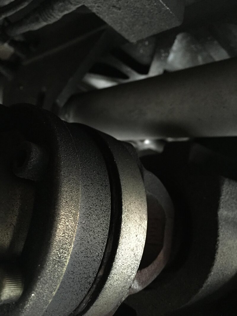

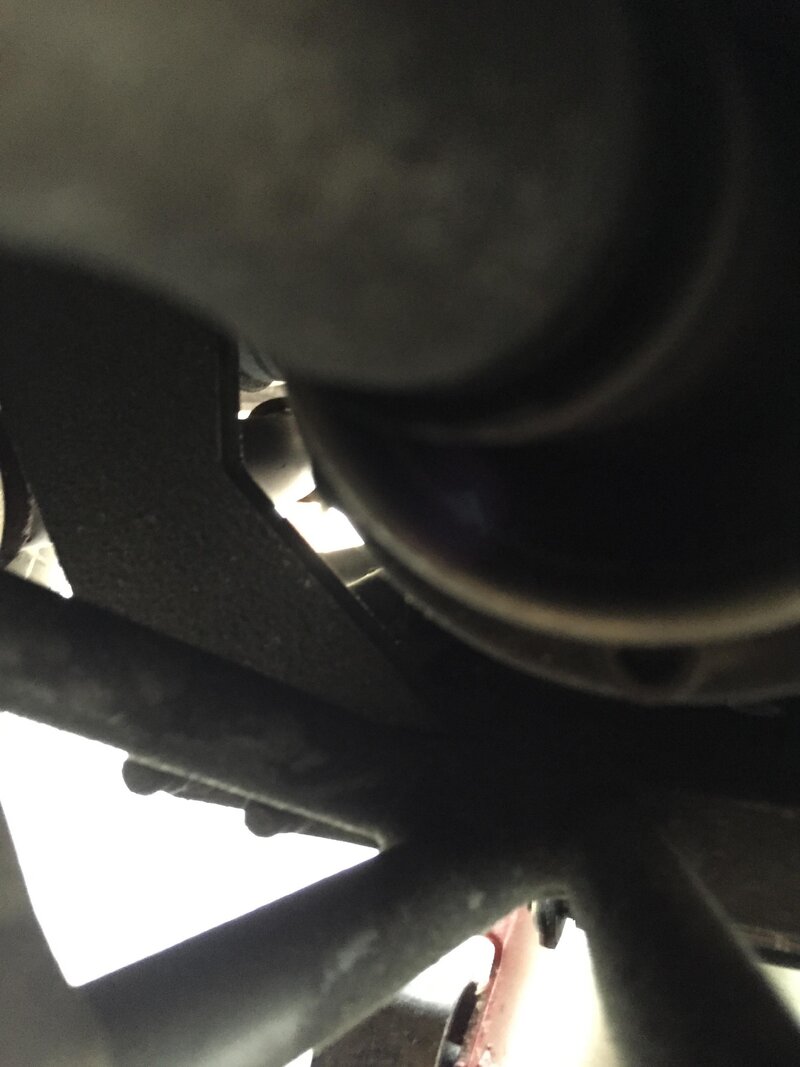

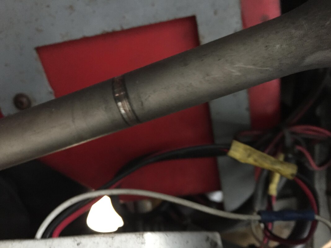

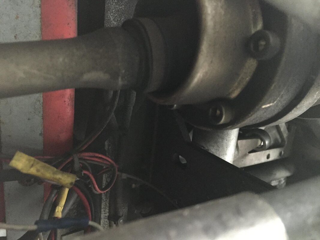

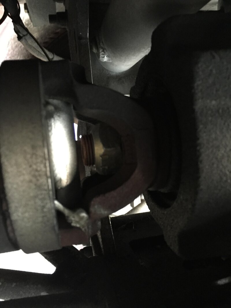

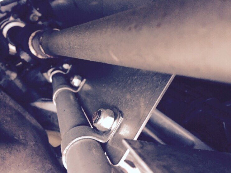

Not yet, I just started looking into this. can you send a photo of your shaft? does it show any wear?
Driveshaft
When I get home from work I can get you a photo, no wear that I see, its dirty
I got under the trike as much as I could without jacking it up to take a few photos of my current driveshaft. Perhaps it has already been changed. Does this look like original equipment?
YES its been changed , & you do not have the gearbox. from what I can tell it looks like a mountain driveshaft to me, whats the picture with the rub mark on the drive shaft ? I do not understand how these things get so greasy & ****ted up underneath ?
It appears to me that you don't have the aux gearbox and yours is like my '05 CSC Cobra. It has the funky driveshaft with the rubbery feeling. Mountain Trikes kit will not fit on yours per Stan at Mountain trikes since you don't have the aux gearbox.
