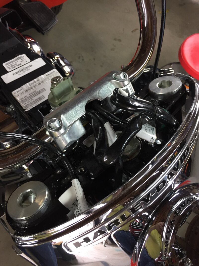

I'm assuming that I'll need to get complete access to them to run the wires for the heated grips. I'll be installing them this weekend, so I'll be sure to post pics for future use.
Gotcha, after removing the black trim insert around the lock you will see the screws that hold the Chrome Riser Cover on. 2 screws and remove

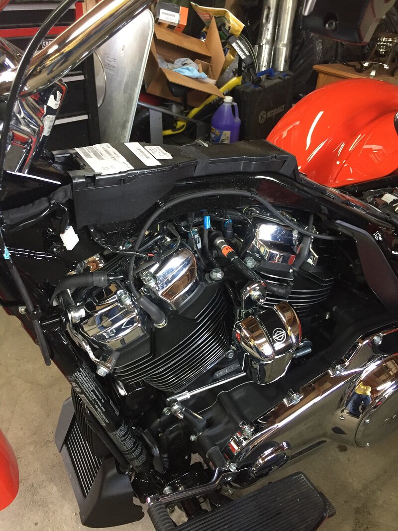

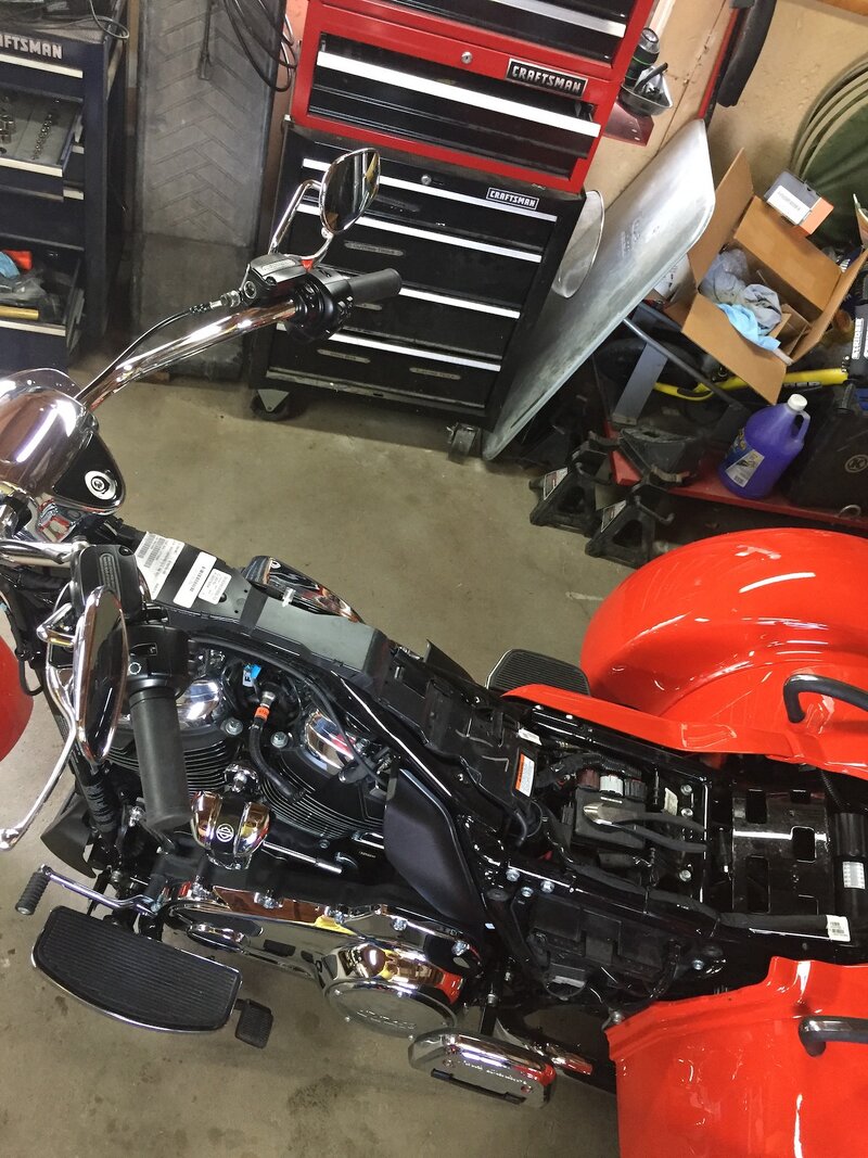

Well I completed my 1,000 miles service today and installed the heated grips.
Unfortunately, they're not working. They are connected to 12v switched power and aren't doing anything.
I pulled the connector off of the end of the right hand grip and there is power at that point, so I'm assuming that everything must be hooked up correctly.
If I don't come up with anything else, I'll have to return them for another set. :-(
Got the problem solved!
One of the extensions that came with the wiring set, crossed the leads.
Fixed that and now they’re working fine.
