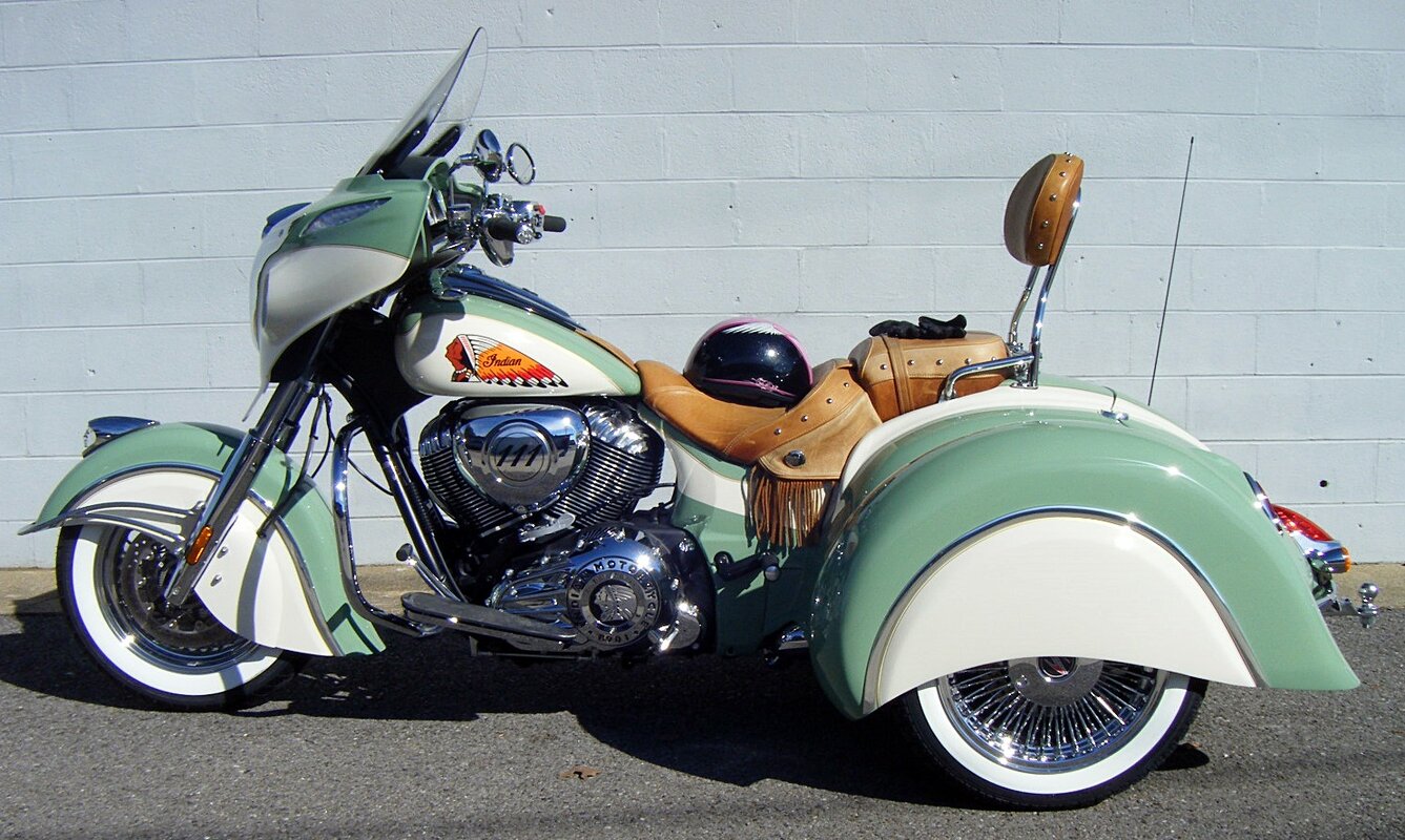

On another note, we have completed the integration of the OEM Passenger Backrest into our Trike Conversion. We realize that although it does not completely satisfy the needs and desires of those seeking a Tour Pack, it does add much comfort and style for the Passenger making the Bike and Trike more functional for two-up riding.
Also, given that the mounting of any Tour Pack to come will probably be in similar fashion to this Assembly, the groundwork is now there for easy assimilation of an Indian Tour Pack once it hits the Streets and Showrooms.

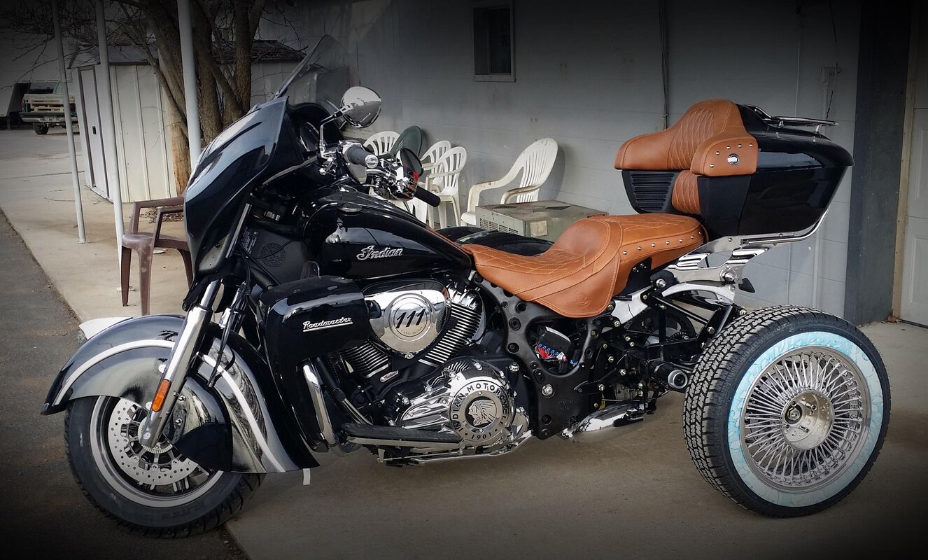

as Predicted & Expected...
Re: Exclusive 1st Photos Indian Trike by Hannigan
I just received an e-mail today from Indian for their newest model. The Roadmaster;
http://www.indianmotorcycle.com/en-u...mail&WT.mc_id=
The Above posted by Rich aka rmrc51 on another Thread......
:clapping: BRAVO Indian Motorcycle / Polaris Industries
:clapping:
I just hope they design the pac to match the overall style of the bike. Most pacs to me look like a cancer growth stuck on the back. Victory is the worst offender in my opinion. But we all know what that is worth.ThumbUp

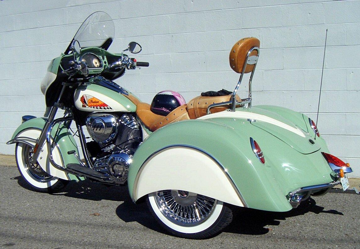

Changing Rear Tires on a Hannigan Indian Trike
Questions have been raised about changing the rear tires on a Hannigan Indian Trike. It is actually quicker and easier to remove a rear wheel on this trike than it is to remove the rear wheel on many two-wheeled motorcycles. With the trike the owner can actually take the wheel off in his garage at home, whereas motorcycles without a center stand require the use of a lift with a drop down panel.
Since motorcycles do not normally carry spare tires, Hannigan Motorsports suggests that all riders carry a tire plug kit, or a sealing product such as Fix A Flat. Punctures are extremely rare on Hannigan trikes,and with the Hannigan suspension system rear tires normally last in excess of 50,000 miles. However, things do happen, and changing a tire on the Hannigan Indian trike is actually quite simple.
To enhance the beauty of this trike, Hannigan decided to eliminate seam lines by building a one-piece body which incorporates Indian-style fender skirts. To accomplish this required an innovative approach. Instead of removable fender skirts, Hannigan developed a unique mounting system for the entire trike body.
Remove the seat and unplug the wiring harness. Remove the four 5/16 inch nuts that secure the body to the frame. Two people are required to lift the body off in order to remove the wheels.
The procedure takes about 30 minutes, slightly more if there is a backrest installed on the trike. Reverse the procedure to complete installation. Detailed instructions are given in the owner’s manual provided with each trike.
