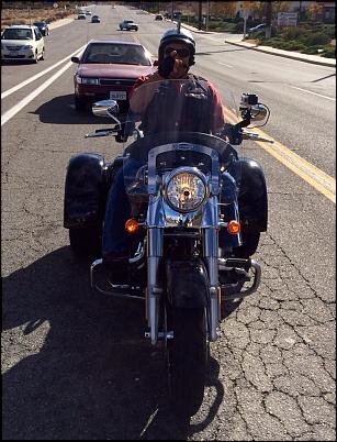

Let me back track. I thought the picture of the orange FW was your bike. I called Andy at Clearview and he said the guy with that FW ordered it 2"wider and 2" longer.That's why I asked you if the buffeting was less. I don't know if the brackets for the FW,RK and Heritage are the same where they mount up to the forks, but the hole pattern is the same on all them. I think the only exception is the CVO RK which has 7 bolts along the top horizontal strap. As long as you have 5 bolts along the top strap they're all the same. I bought the HD FW shield with brackets and mounted a LRS shield to them. I got the Heritage shield instead of the RK shield because the opening on the Heritage is smaller. What I' saying is the RK, Heritage and Switchback shield will mount up to the FW brackets as they're all the same hole pattern.
