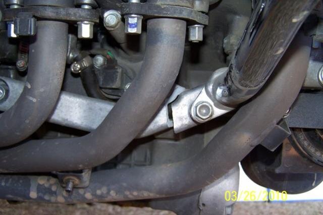

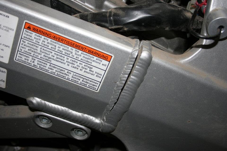

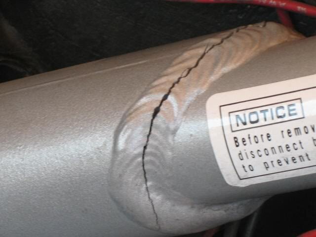

I saved some with photos back when that was a popular item for the recall, The recall is still open and if yours has been checked there's a Punch mark by the VIN under the side cover..... I had my 2003 inspected but always wondered if they really looked every where.... 72,000 so far.....

I think there is some confusion about frame crack history.
Some say mine was done, which could mean, inspected, or gussets added
for repair or preventive ideas. Im surprised cracks show up all over
in un related area's to each other. Many models had problems, but most not this serious.
