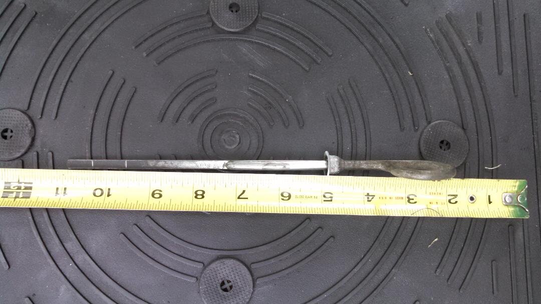

How long is your dipstick
I could send you pictures, But i'm unable to since the FBI has confiscated my camera equipment....:blush:.........:D
I knew this could get out of hand but it looks like someone may have trimmed some off the dipstick tube in my motor. I noticed a jagged edge at the opening this after noon. If this is the case it may explain my oil issues.
So you're looking for how much of the tube sticks up out of the block, Robert?

Probably an any port in a storm dipstick , And the previous owner just cut it back to make it fit/plug on the tube....:Shrug:
A odd question, but a worthy one. I ran across an article about aftermarket dip sticks and how accurate they may not be.
I have this chromed one, it is impossible to see fresh oil on it, but it is what the engine has on it.
I guess one might have cut on it, but they dipstick head can cause a lot of abuse when sliding it down, some like to push and cram it down. This type of abuse can damage it for sure.

On my 1973 Type 1 engine, with dipstick removed, the tube sticks up 1-1/2" from the deck of the block. (+ or - a mm or 2)
I'm running with an aftermarket dipstick & when placed next to the tube on the deck flat where the tube comes up from, the tube height measures a little bit lower than halfway between the high/low marks on the stick.
