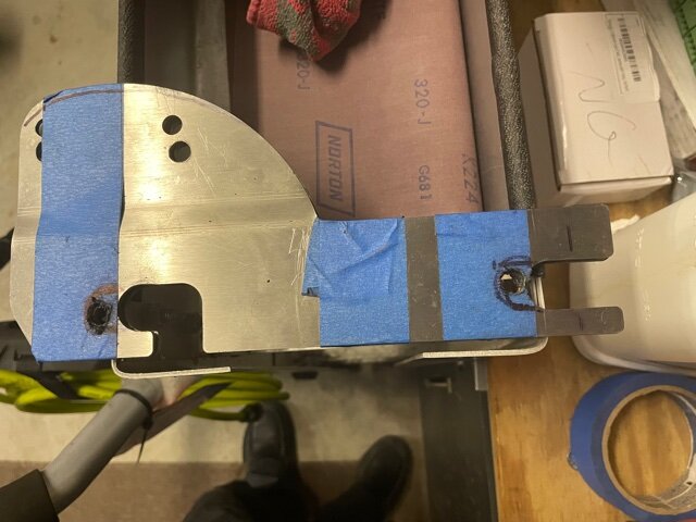

This is how I modified the brackets

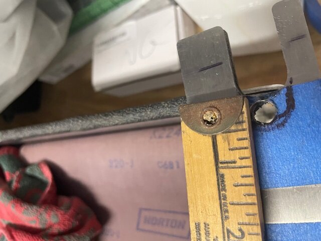

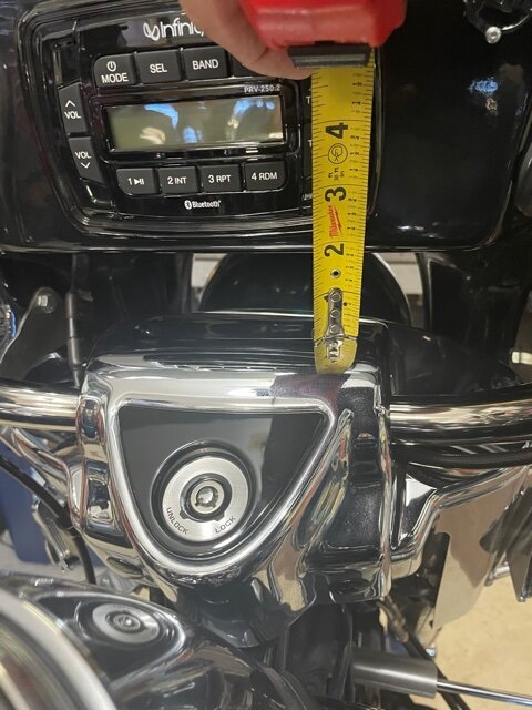

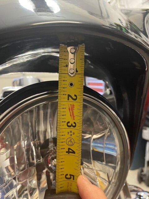

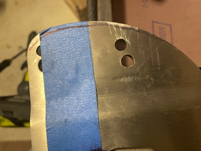

First I drilled the top hole 1/2 in on the original bracket. Then I measured the distance for the bottom hole . To insure the holes matched up, I put screw in the top hole I drilled into the original hole on the bracket for the second hole. (the holes will line up the the mounting holes on the fairing) Note: you only can drill the holes back 1/2 inch or you will have to shave down the back of the brackets. Then I taped the brackets together and marked and drilled a hole on the upper and lower mounting openings. The tape on on the top and bottom of the brackets is where I was going to cut and modify. Use a dremel to cut and remove the metal. After the brackets were cut and shaped , compare the brackets the make sure they are the same height . Then I had to cut the lower part of the bracket 1/2 inch (the lowered bracket hit the turn signal lights)

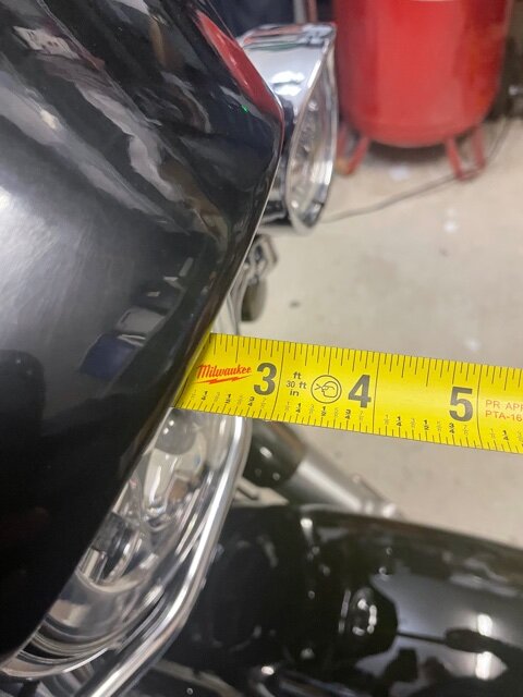

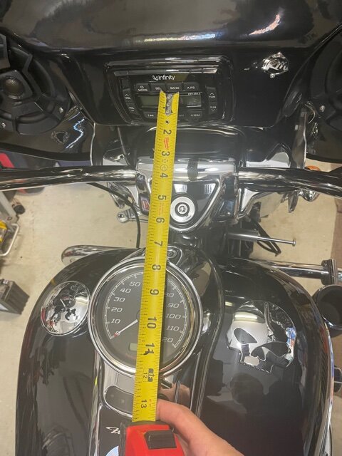

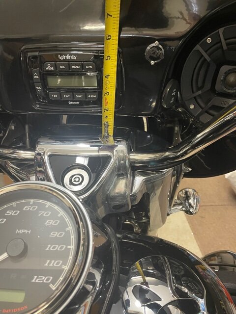

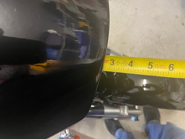

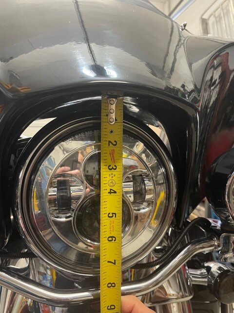

When I first got the bike I saw the large space between the Fairing and headlight (if you look at the first and second picture you can see the difference). I have seen how other fairing fit and also read how the fairing could be lowered. The fit now looks a lot better .
