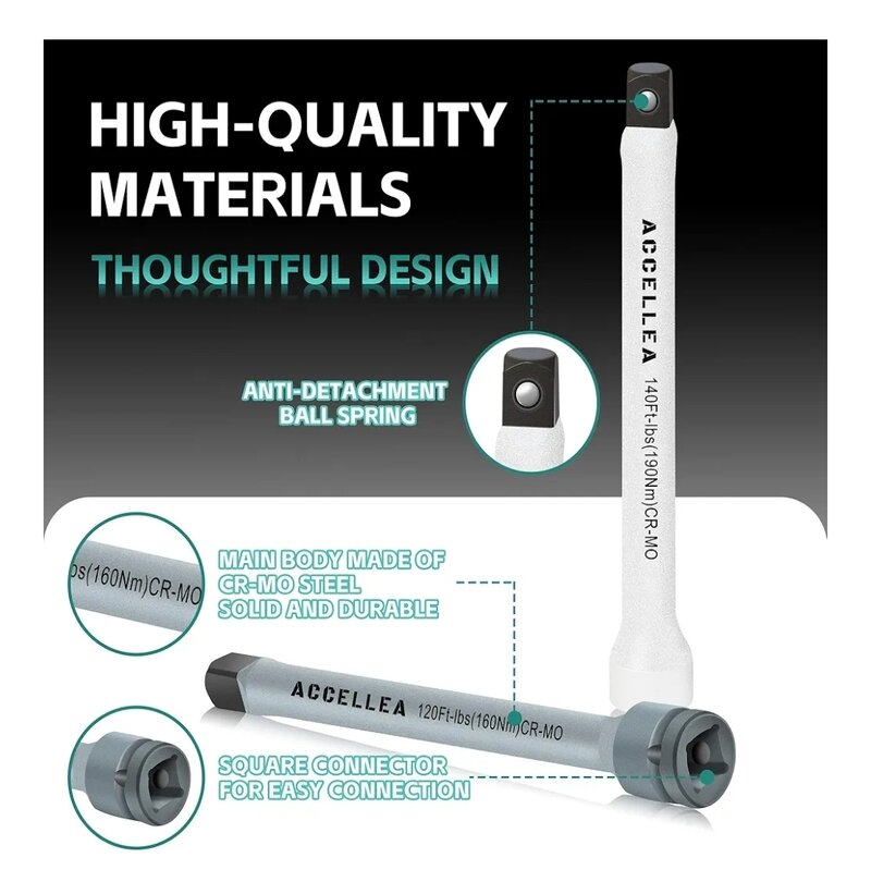

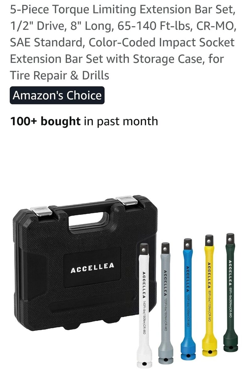

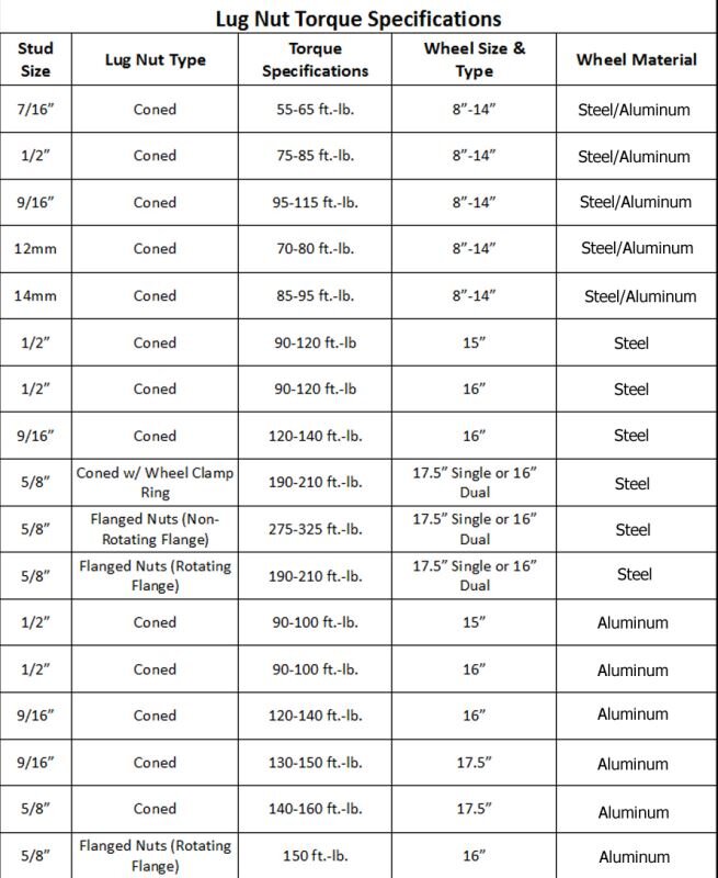

You'd be surprised how many trike owners do not regularly check their rear wheel lug nut torque. I believe a the contributing factor for this lack of attention is that many trike owners either do not own a decent torque wrench or they get lazy/complacent and just dont want to or forget to do it. We always torque ours to spec using a calibrated torque wrench but there is an alternative that will keep your nuts a safe range.
If you do not own one, buy a good quality impact driver and purchase a set of Torque Sticks. These are impact driver extensions that set the torque to a preset ft lbs. It makes the process quick and easy and there is no excuse for not regularly checking the torque.
