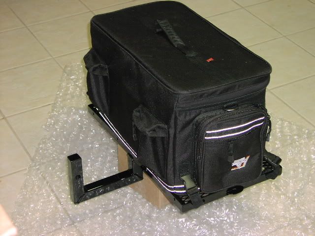

Many moons ago when my wing was 2-wheel, I welded up my own rack to match a cargo bag that I already had.
The receiver will take 1" tube, sides were 1" angle and bottom was expanded metal. I then powder coated it. Here are some pics:

Looks like you did a professional job on this-wish I had the equipement, but maybe I can find someone to help. Tx for the px & info.

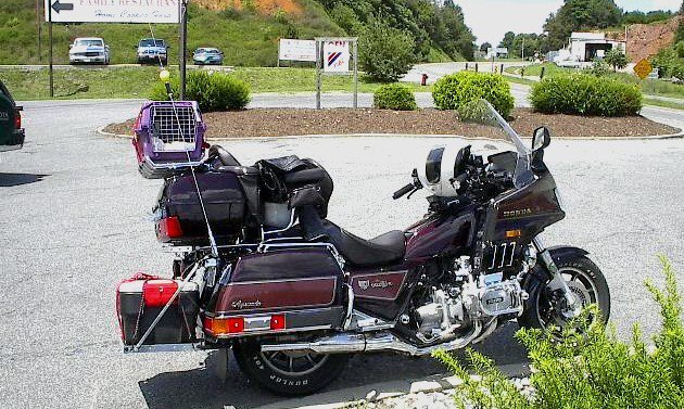

Back in the '90s when we had just the '85 GL1200 I outfitted it with some tabs under the saddle bags tied into the hitch reciever frame work and a couple under the travel trunk incorporated with the travel trunk set back adapter I also made.
I made a couple of carriers, one small for a cooler only .... and another for a "Action Packer" cargo carrier or "tote". They come in colors .... I have several. I use a black one on the bike, even attached a plate on the back side witrh reflective markings. It sits across the rear, down low, is easily taken into a room, packs a lot, is reasonably water proof and .... you can preline it with a plastic bag and pack with cloths like Samsonite.
On the 1200, the rack attaches with 6 x 5/16" bolts using either wing nuts and a hitch pin in a hole if removal in a hurry is anticipated ..... or I use nylock nuts and leave in place for a trip. Since the bigger AP box blocked the lower tail lights, I added aux lights with same functions on a bar that attaches with upper bolts and plugs in and a flip of a hidden switch cuts off lower ones and activates aux lights for tail / stop.
When we bought the '97 Trike, the original owner gave me the OEM saddle bags, I considered making a frame to use them on the trike and even had a set of blue prints.
But I quickly gave up on it because while it looks cool to have them matching (and they were even scalloped by the pinstriper just before the bike became a trike in 1998) I just did not find the huge overhang out back so appealing.
I set about removing the Lehman Flatbar drawbar and made a reciever that goes in it's place and even extended the main bar to attach to a crossbar added where the OEM center stand once lived, the reciever is thus very well supported. It uses 1-1/4" recepticle.
I then built a new carrier rack for the same "Action Packer" as used on the 1200, but this time I added some tail lights and a tag mount to the carrier. It get's power from trailer plug. It pulls the weight in closer, less overhang, and is easily stored in a motel room if desired.

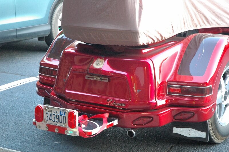

This is kinda like the set I saw in Sturgis. Wish they'd mounted 'em on a trike. Would have given you a better idea of what they look like.
This is a more detailed of my first post on the Honda bags
