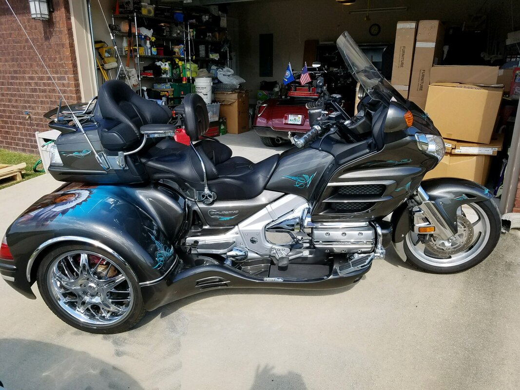

2010 GW
Take picture and post it here. Take a picture of the rear u-joint area where the shaft attaches to the rear diff.
Greg and all the rest who tried to keep me on the straight and narrow, Thank you!
Pulled the trigger on the 2010! CSC confirmed the retro kit for the drive shaft was installed. My bride (she's been a bride for a long time) is very happy! As you know, if she's happy, I'm happy. :homesweet:
