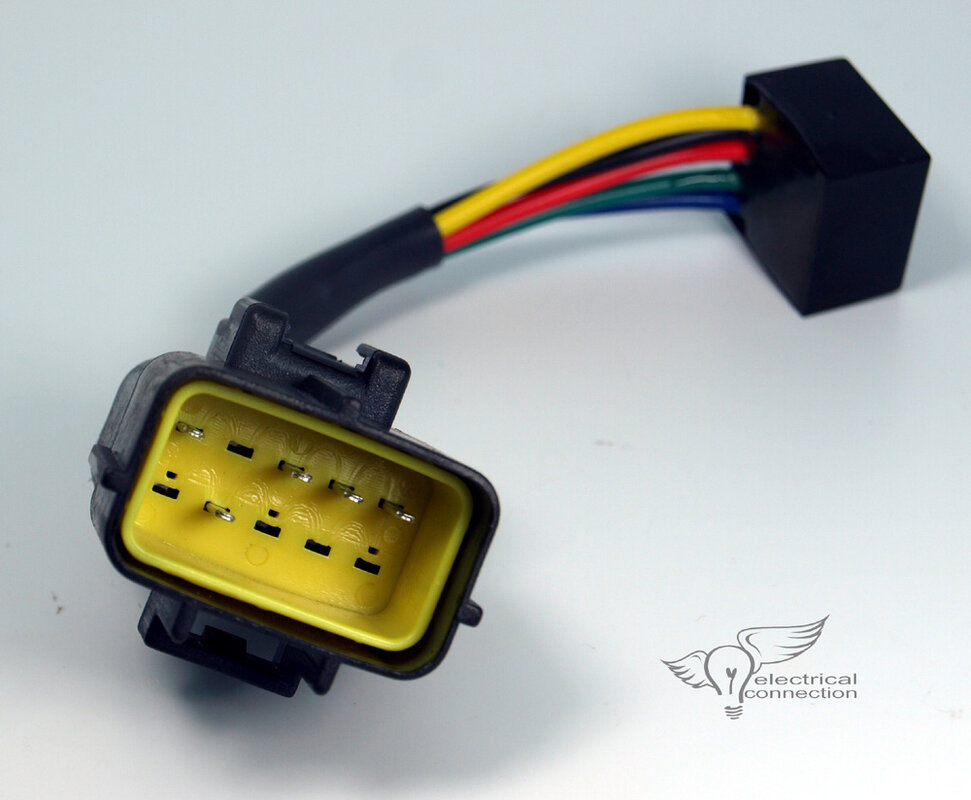

One more thing Brian,
If you determine that your heated grips are working, but your heated seat is not, you can purchase and add a heated seat dummy load module to the OEM heated seat receptacle that will enable your heated grips to function properly. I just had to do that to a really low mile '08 GL1800 that I own after having replaced a faulty left side heated grip. My pretty much brand new, barely used Ultimate seat did not function even after getting the heated grips working.
You can order one here from electricalconnection.
