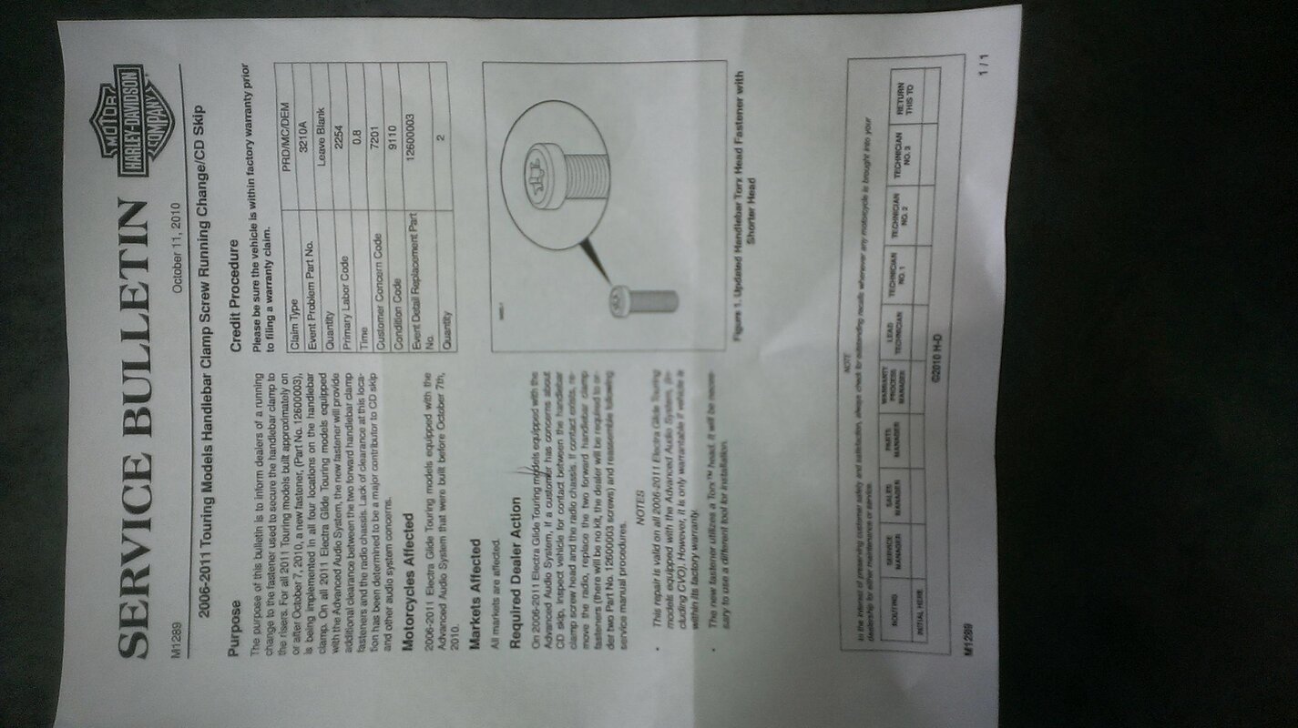

My radio on '10 TG just repaired (extended warranty). HD sent attached service bulletin to my dealer concerning handlebar clamp screws hitting radio. They replaced them while reinstalling radio. This was first time they had heard of this problem. Note the bulletin is dated Oct 11, 2010.
Pic of bulletin seems to have attached correctly from my cell. If anybody wants a PDF version, just shoot me a PM.

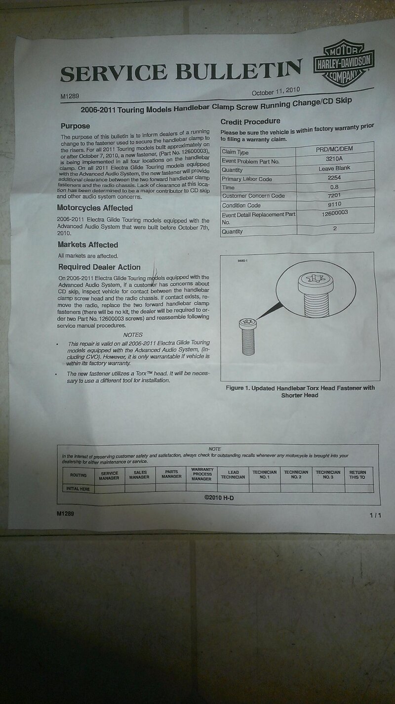

What MY does it cover? Just MY 10? Thanks
Bulletin says all '06-'11 built before Oct 7, 2010 touring models. Here's a right side up pic. A little easier to read.

What does the rear brake rotor have to do with the radio???
Did I miss something somewhere?
You been smoking the hookah? No idea what you are reading. Pic in above post looks good to me. I certainty wouldn't be a stinker and edit it while no one is paying attention.:ImWith: :qpnmt:
