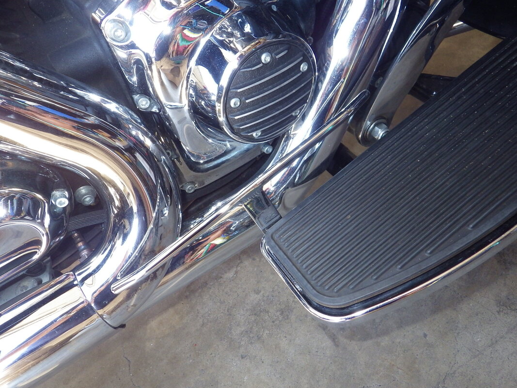

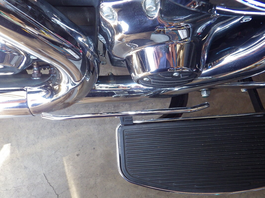

I just finished installing a right side Heel Guard from Carl Miles. It was an easy install ( see link) with just two 1/4" holes drilled into the floorboard. I chose to put a slight back bend on mine, as it gives me a bit more wiggle room but still keeps my heel well away from hitting the pipe.
http://www.carlmiles.com/1010Installation.pdf

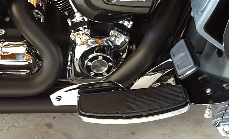

I opted for the HD guard ~ And as everyone said, got real tired of cleaning the melted boot parts off the pipes. Never had a problem since. I didn't even bother taking the rubber off the floorboard. Drilled the hole from the bottom and slipped the Nut/bolt in ~ Easy as pie. Highly suggest the guard. jc

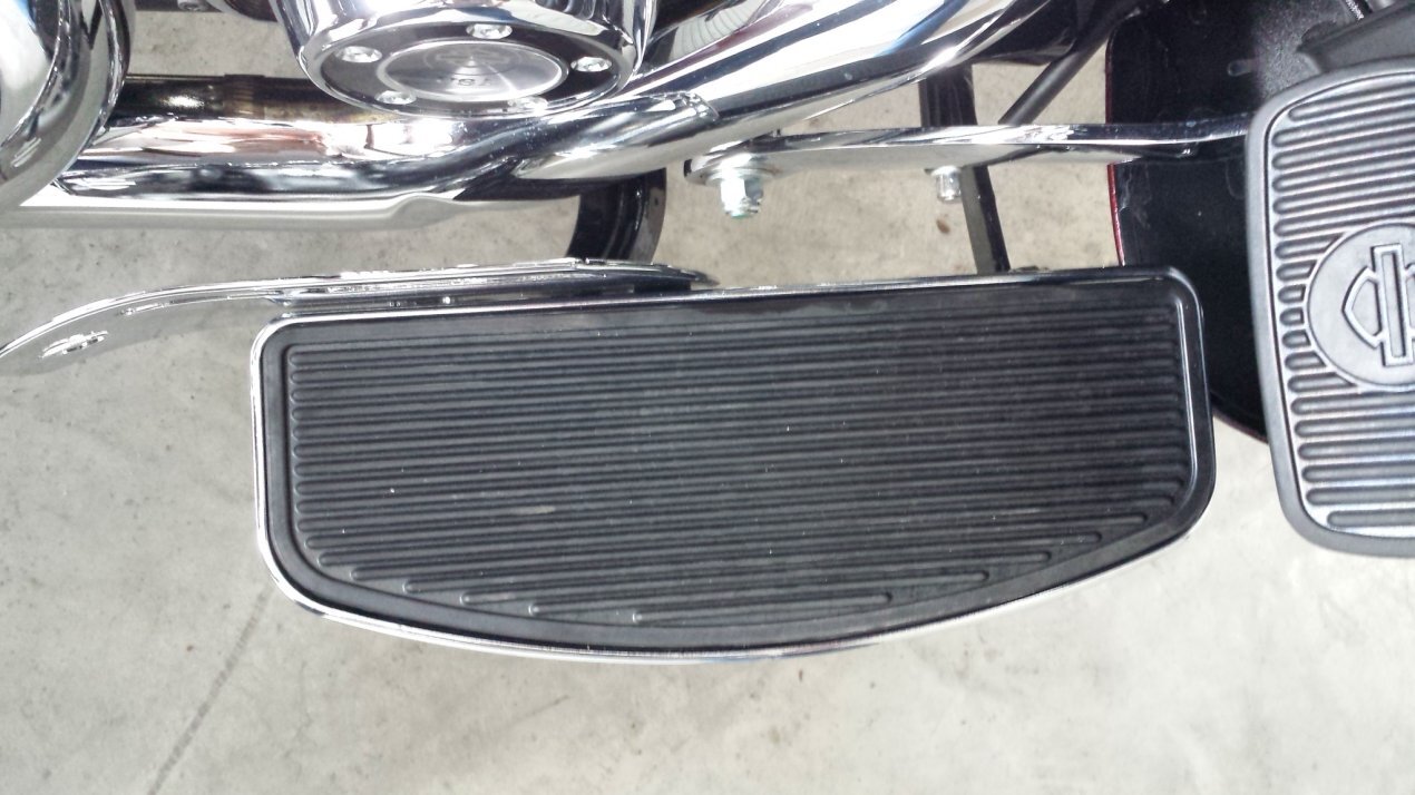

I also have the HD heel guard with the DK floorboard extenders, one of the first things I did after cleaning the exhaust pipes after every ride, not fun. Easy install and I haven't had to clean up the pipes since.
