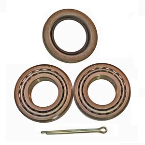

Re: Harbor Freight Cargo Trailer - sorry it took so long
Ok,
I promised this a long time ago and Im sorry it took so long.
Here is the part number for the harbor freight trailer (8in wheels) bearings, PLUS something added that i just found out about.
The Timken number is L44643
The Seal part number is:
Manufacturer SKF - Part number:12165, Note: this bearing has the deeper walls. I like this..more metal.
Ok not for the big reveal.
These bearings come in a kit from timken. and it is available from AutoZone, and Orilleys.
It has:
2 L44643 bearings
2 Races
1 inner seal
1 cotter pin
and a tube of totally useless grease
All for about $26.00
there are 2 models of this kit
the BT-101 & the BT-100
the difference in the kits is that one has the deeper walled seal, one has a shallower depth but both would could work
here is a picture...
