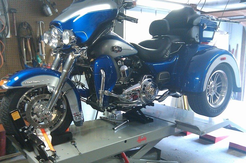

Greetings Gents, I think I have pin-pointed my choice for a lift table. Handy Industries BOB. The question I have is this. Would it be a more beneficial for me to get the side extensions versus the trike adapter? I guess the only benefit for the trike adapter is that once can get closer to the trike. But the full length 12" extensions would allow a two wheel bike to be used and also lawnmowers. Should I get the extensions or the trike extension? Mighty obliged.
I've been working off one with the Trike adapter, the down side I've found is my 2012 Hannigan converted Wing doesn't fit. Its a might too wide and its too long, a Triglide or shorter and narrower trike will fit it just fine.
Thanks for the info. It appears that with my wife's Roadsmith would work on the side extensions since it is the same width. I understand that there is a 'wide trike" adapter kit that is something like 62" wide. Regardless I will need the front extension that will bring it to 97"
Why buy all these adapters when the K&L trike lift is complete, I have an extra 24" of length and plenty wide for my Roadsmith? You might check around... price isn't much different time you add all the accessories and you get a much heavier duty lift that goes 48" high.... :pepper:
