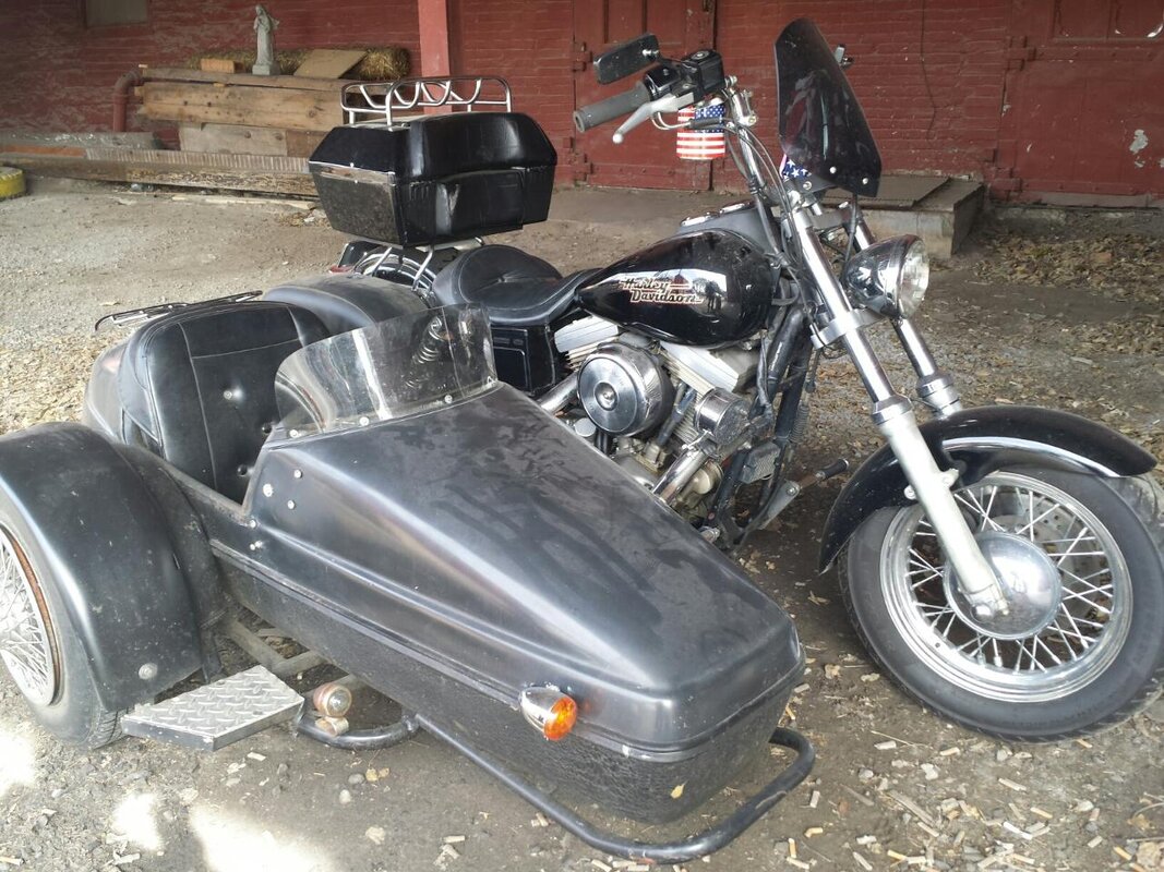

It is a hub cap, axle was changed years ago to larger size and a trailer wheel tire installed, cap has been on for years and many miles not the best fitting but works. Never came off to my recollection even on 2 trips to Sturgis. Thought about changing it but for now everything stayin the same , to many memories. Thanks for the comments.
Looks like a good ride you have there, Bill. Don't see many FXR's with "sidehacks"!
A steering stabilizer might help, if you feel any twitchiness or wandering while going down the road.
Also there is a certain spec that has the bike tilted slightly toward the hack. Hard to tell from the photo angle if it is already set. Once upon a time, back when Harley made sidecars, they recommend the "offset" in the installation instructions. Even though this is not a factory HD hack, the offset should still apply. I can't remember the exact # but I recall it being somewhere around 6 degrees. Easy to check for offset: on a level surface stand directly in front of the bike with front wheel pointed straight. It should have a slight cant/lean toward the hack, not perfectly vertical or straight.
That will definitely affect the handling/cornering if not setup right.
Good luck on getting it setup to suit you.
Thanks for the info,will check, only rode it a little after getting it going again, He put over 50,000 on this set up and was and avid rider, I am pretty sure it is done right but things can move, will wait till warmer weather arrives to get use to it. I had an ultra classic with a Harley car for awhile just didn't give it along enough time to get use to it I think, I will try hard this time. I have no problem riding wife's trike but when I switched from motorcycle to sidecar had issues. Probably have put over 250,000 miles on cycles. , they say much easier to learn a sidecar if not to used to motorcycles. Like I said will give my best effort this time.
