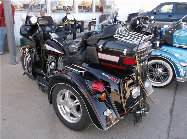

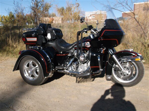

If you want to see what I did when I first built mine to see what you may be up against Google pcombe photobucket/library
if you click on a picture it will enlarge and will give you comments and tips at the bottom of the picture, who knows it may save you some installation frustration?
I hope this helps you?

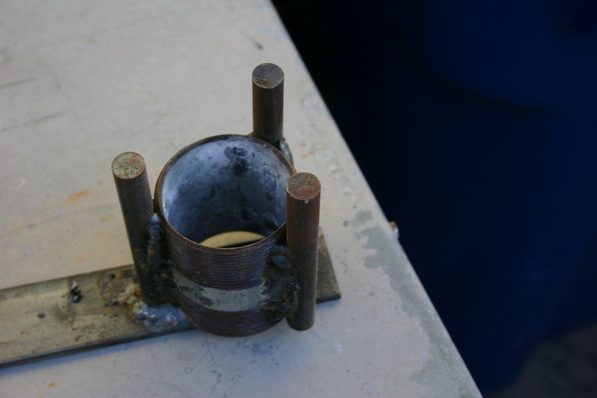

Ray, it would be helpful to post a pic of the output pully holder you made. I know exactly what you are talking about as I have two different Kaw drive shaft spline holders for removing the internals of the bevel gear case. In this case, my tools look like long paddles with a round end with splines in the middle... I am thinking the tool you describe is similar. All Kaw drive shaft bikes use bevel gear cases, drive shafts and such... part numbers are the same since the 1979 KZ1000E to the latest as far as I know.
I will dig it out on Monday and take a picture of it. It is stashed behind my air compressor. One thing that I forgot, you need a hole in the handle large enough so you can fit a 1/2 inch extension through it.. The instructions says to use a new locking device when you put the tranny output pulley on but you can use the old one if you need to. Just flatten it back out.
Output Pulley Holder
Here are a couple of pics of the holder for removing and installation of the output pulley for the Vulcan. As you can see I don't claim to be a welder but it held enough for me to torque the retaining nut to 130 ft/lbs. The fingers are supposed to be 120 degs apart but one slipped but it fits. The hole in the handle is 3/4", big enough for a 1/2 extension to fit through. 2" pipe nipple 3 inches long, Fingers 1/2" round bar 4" long.
