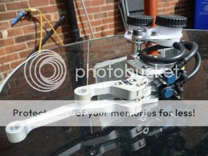

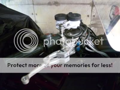

Did a twin brake lever adaption on mine last year,Kliktronic K twin levers...Works brilliant stopping the trike and teardrop trailer....Top lever works front brakes bottom works rear,I have since swopped shorter top lever for long lever,braking issues due to arthritus in hands.
