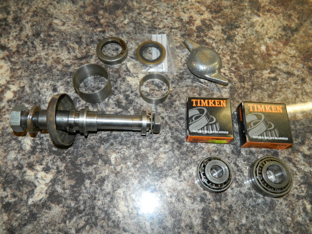

Seemingly ages have passed by since something to report has occurred as far as my sidecar is concerned. Things have been slowly appearing on the horizon though... I have a very helpful friend of long standing who has a modest machine shop, we share an abiding interest in motorbikes...!!! after I deliberated about things, he has kindly made some bits for so as I can convert from Imperial to Metric wheel bearings etc..... these are the bits etc...
The axle now has two manufactured sleeves at either end to take the different bored sizes of the bearings. There is also another spigotted sleeve to make the oil seal fit. The two thin rings above the axle are to make up the 2mm differential between the Imperial sizes and the Metric, above those we have the original, and the new oil seals.... to the right you can see the original Imperial bearings, and the new boxed Metric alternatives. The big nut on the end of the axle is a new one, advertised as a non-Q.D. wheel nut from a 1958 Triumph Bonneville rear wheel.....
Looking at the bearings again... both new Metric bearings were well under £8.00 each, both Timken, as are the originals, however, the larger of the two Imperial ones could cost me just under £200.00 each, the smaller one is an unknown cost..... I think I have gone the correct way....!!!! I could have probably used the originals, but I fear trusting unknown, used wheel bearings on a sidecar....!!!!
