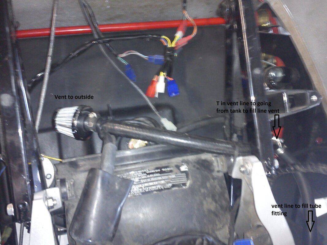

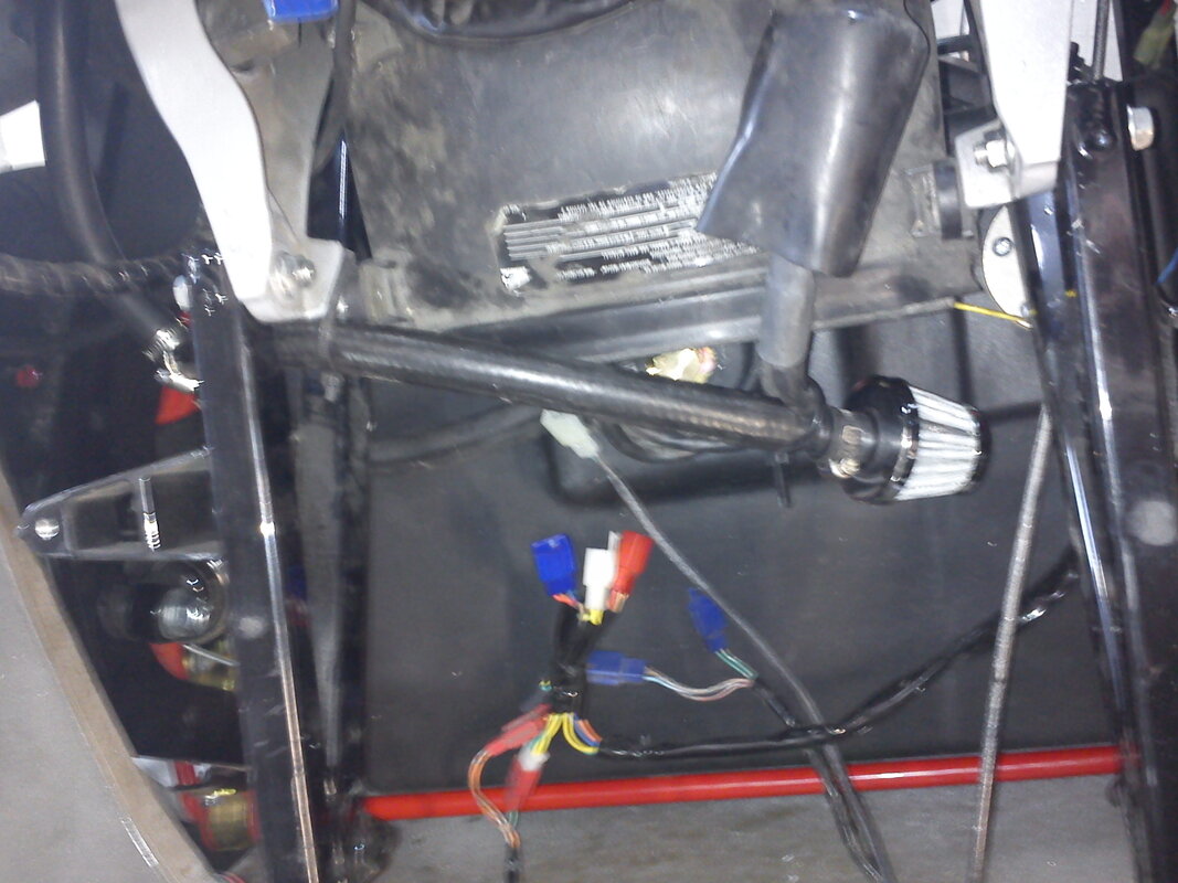

I put a "T" in the vent line that goes from the top of the aux tank to the gas filler neck. That way I knew the tank was vented and vented well.
