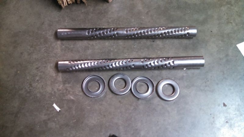

Got the baffles in today here is the kit they fixed up for me.
Getting things ready to start tomorrow.
This may be easier than I originally thought. The ends fit perfect, kinda tight but doable easily. A little polishing and they fit like a glove.

This is 2 different sets put together.
The baffles are for the cvo performance baffles and the flanges from the set you got. It was a lot lower cost for me to do it this way.

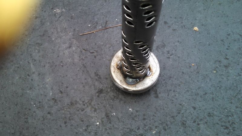

Got the right side finished, working on the left.

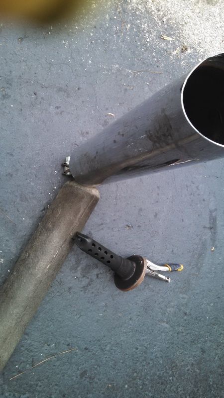

Here is what is inside the muffler:
Baffle
There were some nasty weld that I had to remove to get the baffle out. They were just messy welds in the way, not holding anything on.

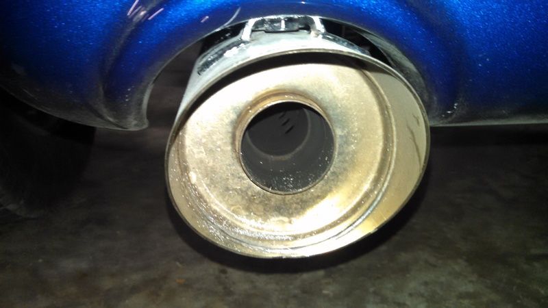

Got finished and took a test ride to the store.
I am more than satisfied It sounds great, deep bassy sound.

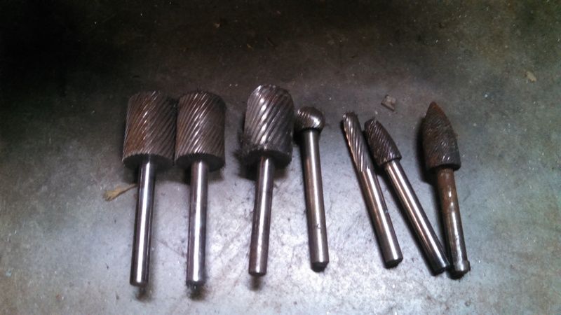

Oh if any one is going to change baffles, look at the photo with my machine bits. One of them is rounded on the end. That is the one you want to use. That took out the weld quick. One the first one I tried different bits to cut the weld but the rounded end one was the one. 20 minutes tops. Could not find a hole saw that would fit right. It was either to big or to small.
These are suppose to be 4 inch but a 4 inch hole saw would not fit but the 4 inch baffle end did. go figure.
The diameter is 3 13/16 inch
