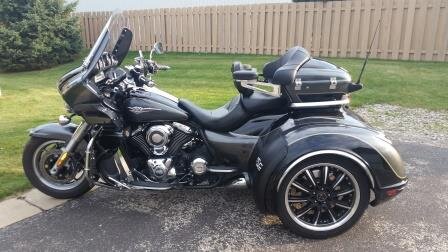

BTW, how are you liking your CSC trike. Looks nice!

Definitely nice!!! ThumbUp

Nice rig as well Ol School...........
