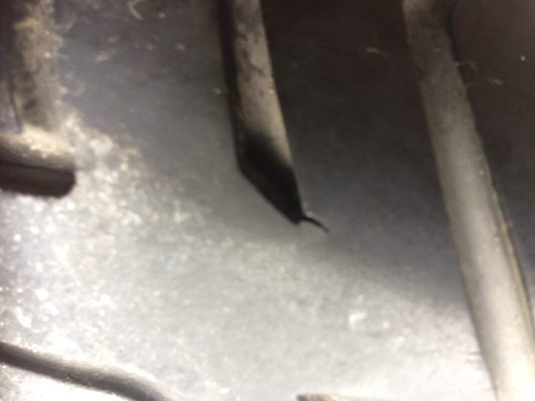

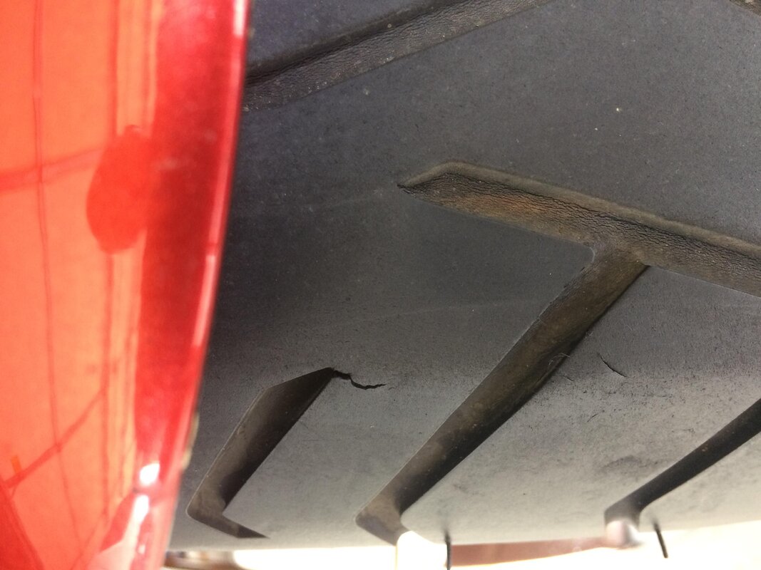

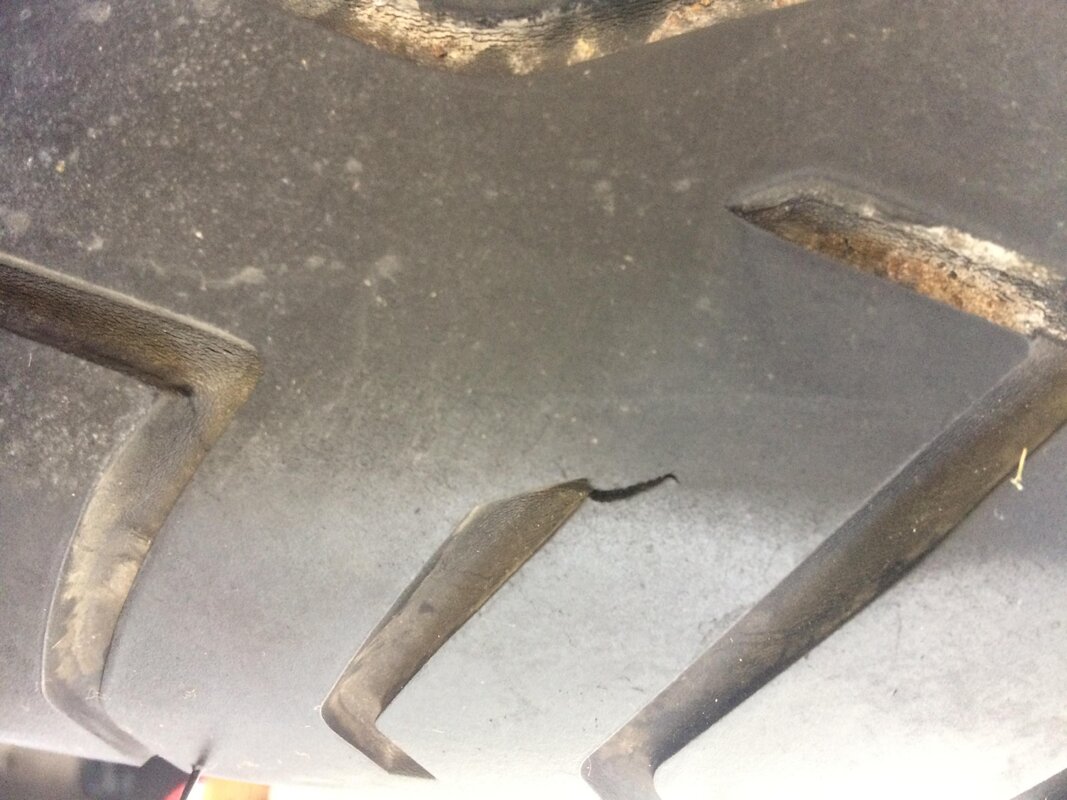

Has anyone had problems with cracks in a Bridgestone BT-45 Sorry the pics are sideways

3 Questions......How many miles on them, How Old are they....And what's the Born on date......:Shrug:..Maybe that was really Two questions...
Its the last 2 questions that count the most.
4th might be what psi do you run it at.
Truthfully those cracks look like what an old tire over 7 years old that's in the sun gets.
More commonly called dry rot.
Because of all the little stressed looking parts in almost all the pics.
Im saying 99% sure Dry rot......

I've had that happen to 2 of my BT 45's when close to 18,000 miles get on them. Never worried much about it. And I've mounted them normally and in reverse so I don't think either caused them

Mine did the same thing, only the rips were much longer when I discovered them. Mine was about 2 years old, had about 8,000miles on it and was severly cupped.
Local Trike installer gave me 2 reasons for this.
1. I was running underinflated for some time,
2. I was being very aggressive in "tight" corners.
He was right on both counts. I was very aggressive during several trips to Deal's Gap.
Also,as I've stated before, whoever came up with the 41psi in the front tire should have kept quiet!!!!!
Lower that to 36 to 38 for a much smoother ride!
