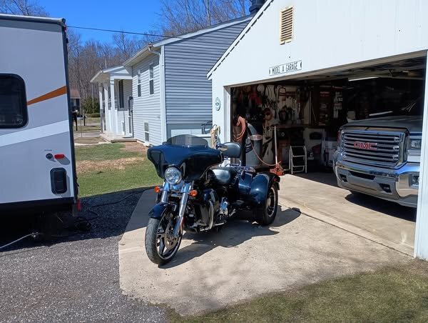

Just put a batwing on my 15 freewheeler but havent had a chance to even ride it thanks to the weather. I also put on an engine guard and lowers.
looks great..let me know

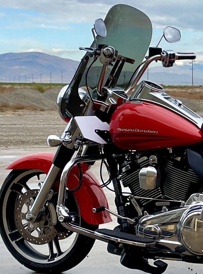

I have a reckless motorcycle fairing on my 2019 with a 8.5” klock werks. I get some wind on my chest but it’s definitely from coming up over the tank. Before I had my highway pegs I would rest my legs up on the crash bar and hug the tank with my legs and wind was gone. I have a tank lift and wind deflectors from DK customs I still need to install. Hoping that helps with the wind over the tank.
I was having my head ripped off on my Freewheeler. Changed to a Freedom Shield, not much change. Added the DK Customs cooling deflector wings. They helped some, maybe about 10 percent reduction in my opinion.

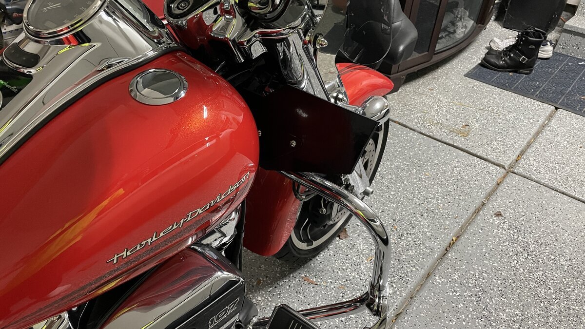

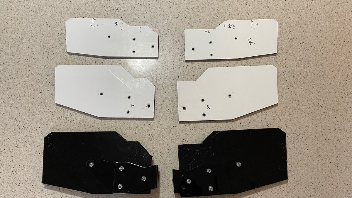

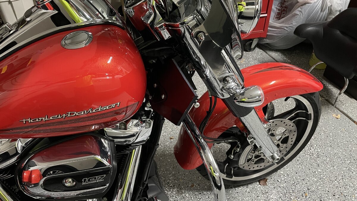

Then I started looking at them and wondered what would happen if they were larger? So, Ive been messing with the size and shape of these things for a while, and have gotten pretty close to optimal. Still tweaking size and angle. Winter got in the way of progress. The photos are of a prototype. The final product will most likely be smoked acrylic to match my windshield.
Not the prettiest look, but I decided lower fairings aint exactly pretty either, and Ive run them on a couple bikes. I would say these deflectors got rid of almost 90 percent of the buffeting. I posted about them on another forum, and a member who asked for the plans and made a set said he thought they made a big difference.
The thing is, The buffeting is mostly coming from below and/or up over the gas tank. As was stated above, If you cross your arm across your chest as your riding at speed, you can see how much blocking the updraft gets rid of the buffeting. And the post from Nels41 about putting his hand on his knee with his fingers extended, is the same principle.

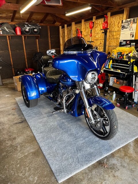

The third photo is of another version, (the white ones) angled more forward.IMG_3053.jpgIMG_3052.jpg75115093436__12A6CB29-5C22-45D0-95CE-06B2097E2EA9.fullsizerender.JPGIMG_2265.jpeg
