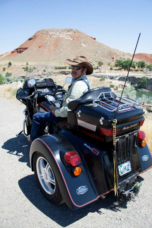

I have a Frankenstein kit on a 1991 FLT. I do not ride the miles you do, but have about 7,000-8,000 miles on it. The rear axle is very high quality with ford internal parts and bearings. Swing arm is a conversion of your swingarm by Frankenstein. Only weakness here is you might want to replace clevblocks with solid aftermarket type bushings. Mine still has stock clevblocks in it. About changing from 3 to 2 wheels in several hours, people that do this must not have raked front tree. You would not be able to ride as 2 wheeler with raked tree used with most trike conversion kits. Anyway, the kit is very healthy. Getting a fix on the road is question. I guess you would have to go to independent bike shop if problem, but all parts are easily obtainable Ford or Harley parts. Wish I could ride as much as you per year.
the Frankenstein kit basically is just a matter of changing swing arms. one for the trike and one for the 2 wheeler. the conversion back and forth should only take a few hours after doing it a few times. I had a tri glide at one time the trike is for riding long distances with the wife and the two wheeler is for going by myself. I know that it would be easier to have a trike and a two wheeler but here in BC the insurance is so costly it is not feasible (about $1,500.00 per bike a year)
Ok, I will accept your explanation.
Yet I question the advisability of switching back and forth?
When I converted my old 1989 tour glide I kept the parts to return it to stock but the amount of work involved would be just as excessive as building my trike to begin with.
Doing the work myself I have about $8,000 into the job and I cant see investing the money only to return to what I left. besides the work involved was allot more than one might think, admittedly it is a more complicated conversion than a Frankenstein.
Even after the conversion process it takes time tweaking everything to get it right? a couple hrs. just may turn into allot more.
A piece of advice?
every time you change swing arms use new bushings, they are a wear part and only run hundred dollars each time you do it.
