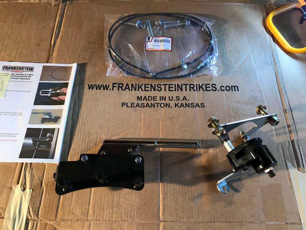

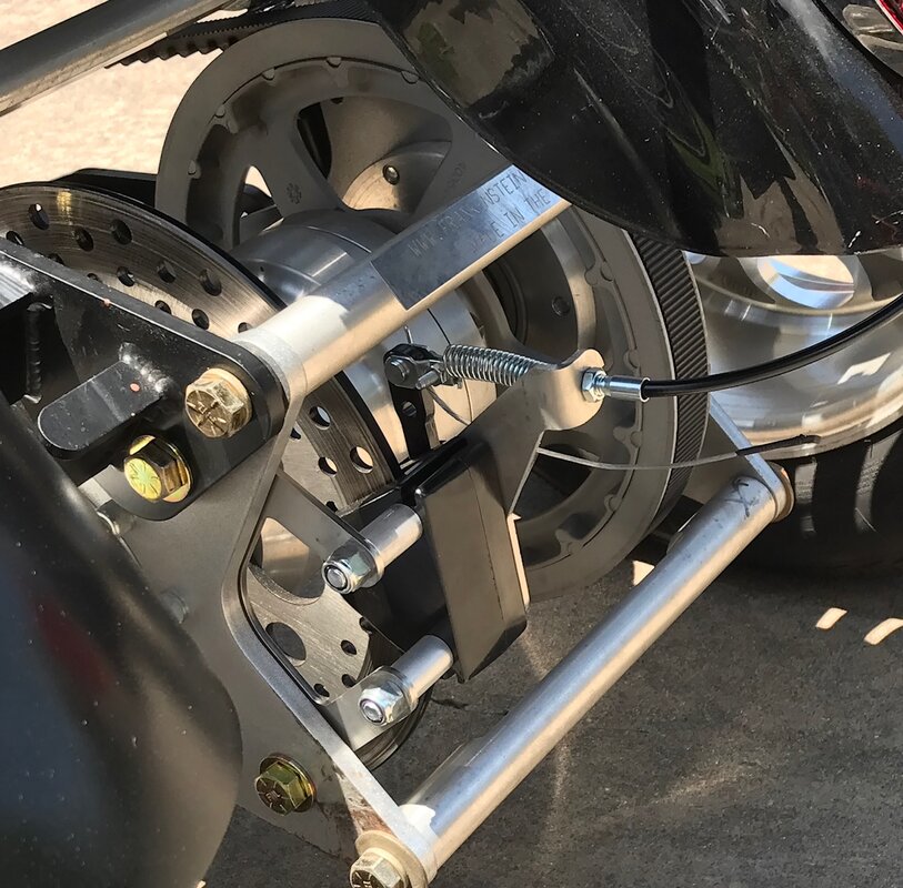

Parking Brake Installed
I installed the Frankenstein parking brake kit on my wife's sportster. The kit was easy to install and works well.
I have included a picture of what is included in the kit and the final install.

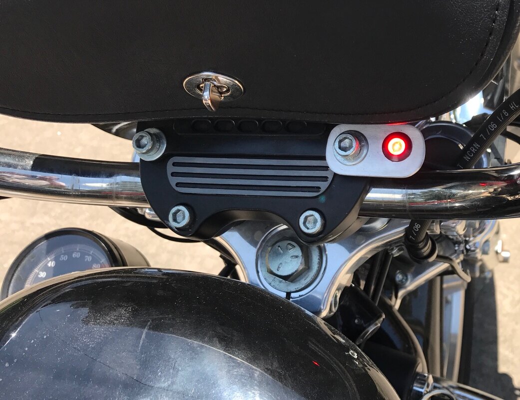

In addition to the kit, I added a brake switch and bracket wired to an LED light on the handlebars. So, note that the brake switch and LED are my add-ons and don't come with the kit.
