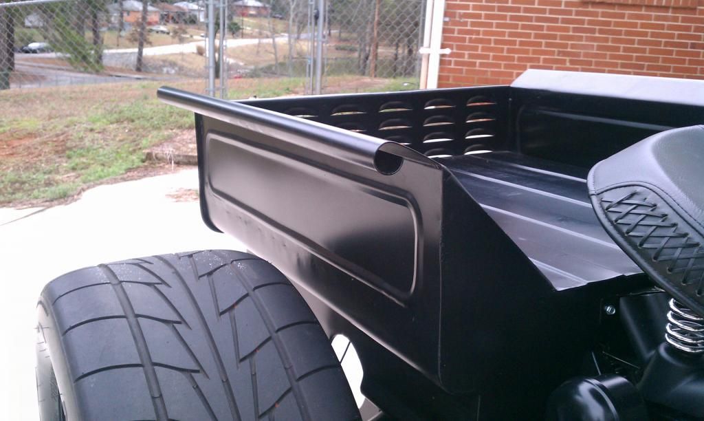

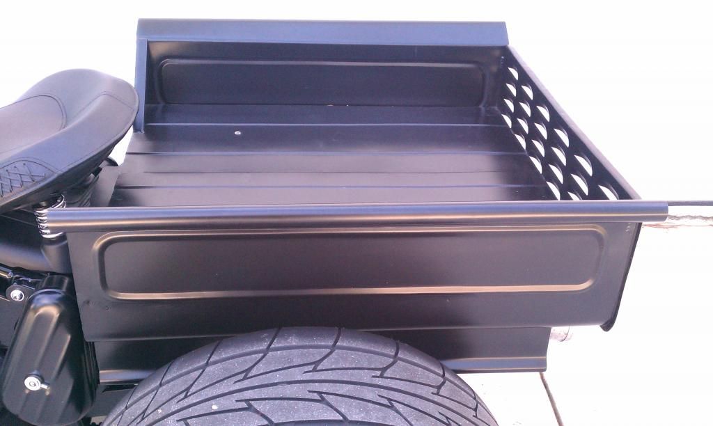

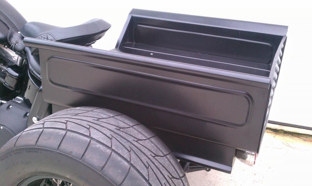

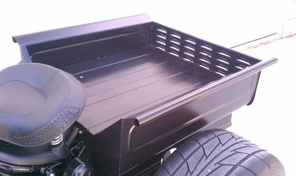

I really like your truck bed. If I was crafty I would have something like that. I have a vision of a wooden stake bed. I would not know where to start to mount the bed. Let alone fab the bed. You like the big radius? I am going with those also, short shots are too loud.

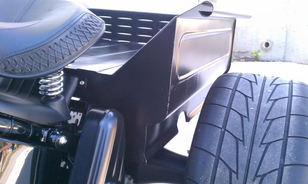

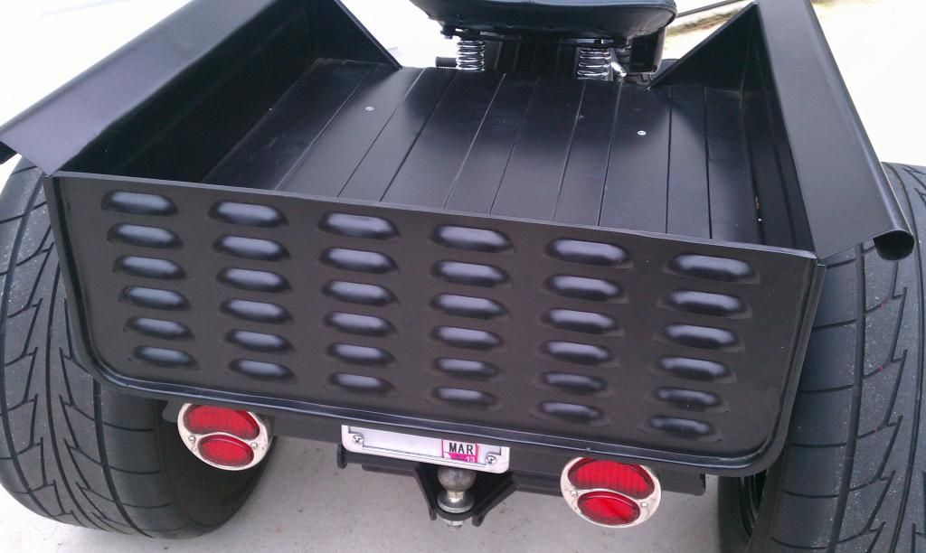

Thanks! I had a local fabricator build it to bolt to the stock frame struts. Paughco now makes a similar bolt on bed. I love the big radius pipes, plus they direct the exhaust down and away from the axle tubes. I think they sound great.
That paughco bed is cool but they are proud of it.
Yep, but truth be told I'm at $1K for the custom job and powdercoating. I still need some body work and painting. My fabricator says he should have charged me more based on his time but he stuck close to his original quote. He said he wouldn't build it again for less than $1500. I haven't seen Paughco's quality in person but if its good, their price for a bolt on bed with no fabrication required seems fair. Here are some better pics of mine:

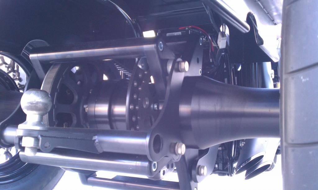

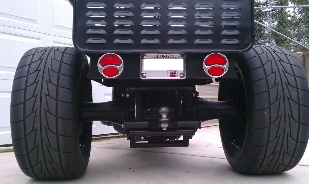

I have noted that your trike incorporates the Frankenstein tow hitch and the single, inboard brake. Have you towed anything with it? What is your experience if you have?
I would like to have the ability to tow and I was thinking of following Frankenstein's recommendation of using the 2, outer brake setup. But, that is at an additional $450.00' so I am trying to determine if that would be the right path for me or not.
