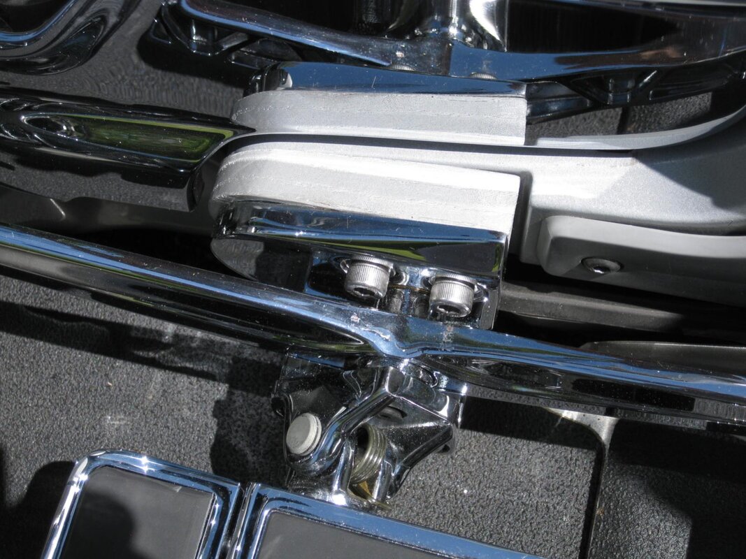

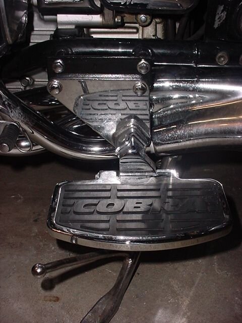

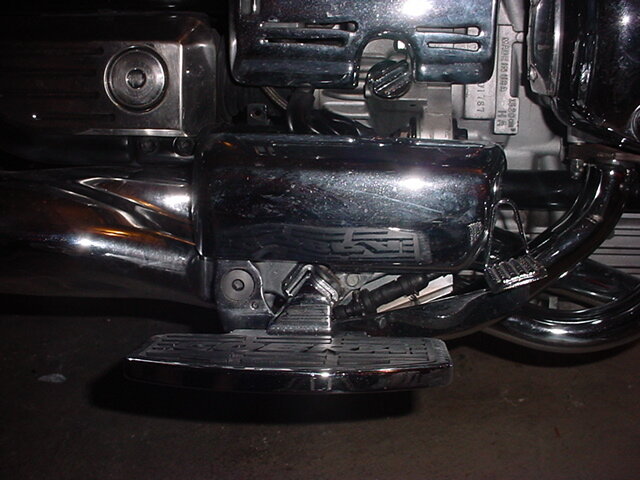

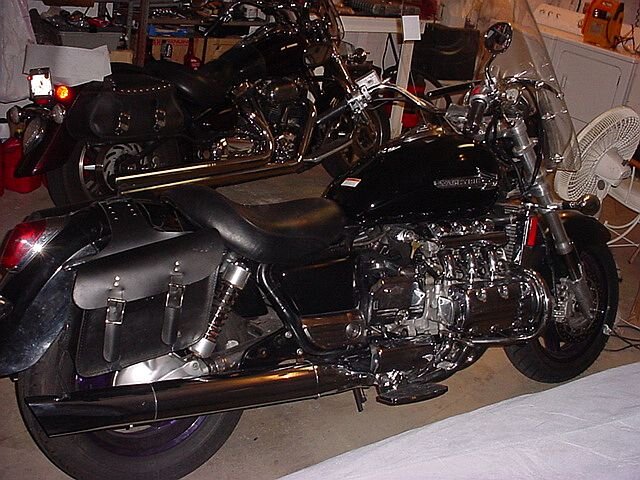

I made my own lowering brackets from some steel plate.
I dropped the pegs an additional 1.25 inches.
A lot easier to get my toe under the shifter.
But.
If your a peg dragger??
Not a good thing to do as your about 2-3 inches from the pavement.

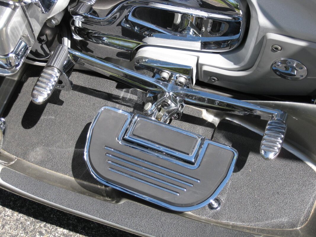

A few pics to show how low I went. I hope they give you some ideas.

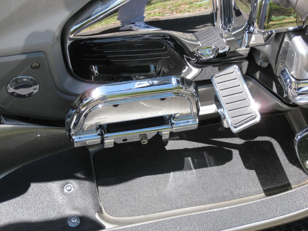

I used the Kury floor board set up with a piece of 3/16ths steel made from about a 6x4 inch piece of steel plate.
Just drill holes for the top mount and for the pegs brackets as low as you feel you might want.
The brake or right side. Due to the pedal and linkage takes a little more work but wasnt to difficult to do.

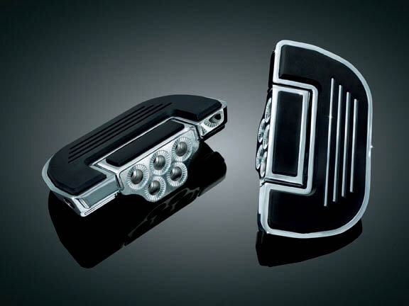

This will also work... New Foldup floorboards or the Heel toe shifter or both. Need more room fold the board up and put your feet on the Wing Guards.... look at the spring on the other side! Will only work one way....

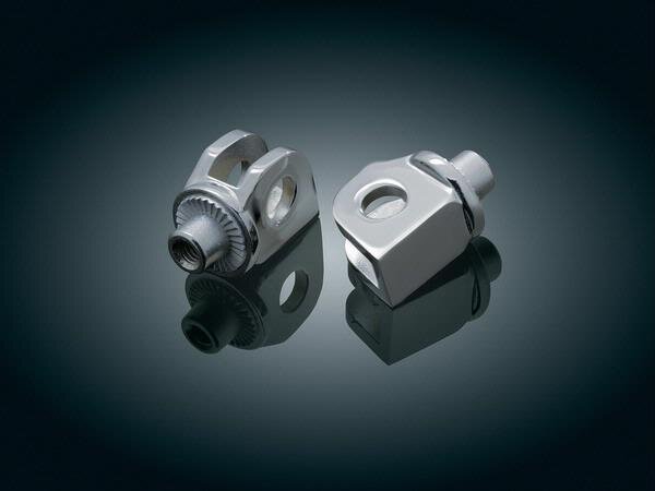

the beauty of those Kyrakyn boards is you can adjust the position of them, I have them on my 750.... not sure if they will stay after triking it or whether I make full length boards :)
