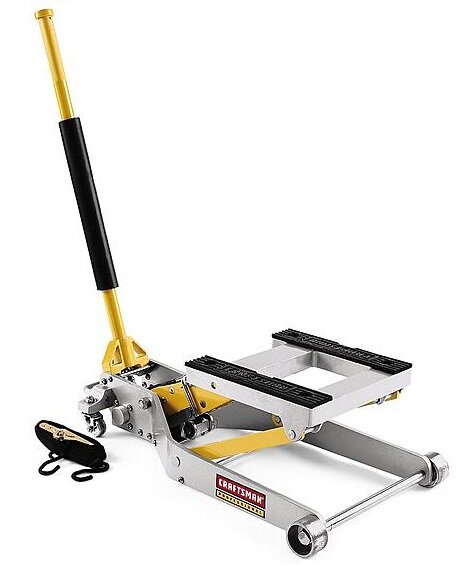

My Harbor Freight motorcycle jack does not fit under the bars for the aqua shield. Even if I take all of the that stuff off, I don't see anywhere to SAFELY jack up the middle of the bike with the jack.
Using my 1.5 ton HF floor jack, I did not feel very safe jacking it up. Additionally I only have 2 jack stands. I tried jacking up under the rear diff and under the tow receiver. Both spots allow the trike to severly lean towards one side.
Get this jack... it WILL fit under the aquashields of a spyder 2+2
http://www.sears.com/craftsman-professional-1500-lb-motorcycle-atv-jack/p-00950191000P
This jack comes with additional "legs, so that you can make one side of the jack higher than the other, thus it will compensate for the "lean" if you jack under the pumpkin
Secondly even with the lean I have never had my bike fall of this jack even without the arms

I have done it by myself but you have to raise UP on the grab bars, and push WHILE you hold the button... it can be done
The better way is once you get the rear end up on the ramps, then use the yellow jack under the OEM aluminum frame of the bike and raise it there. Once you do... (I have 2 sets of ramps) put the front wheel on a ramp. thus the bike is supported by all 3 wheels
Additionally...
if the bike is up in the air supported by all 3 wheels, you can easily jack up on side of the trike (one rear tire) just enough to get it off the ramp, and the bike will still be supported by the other 2 wheels, and you can remove one side tire or the other.

See post above Sears craftsman yellow motorcycle lift

I'll consider the sears jack. Only 1 left in stock locally.
