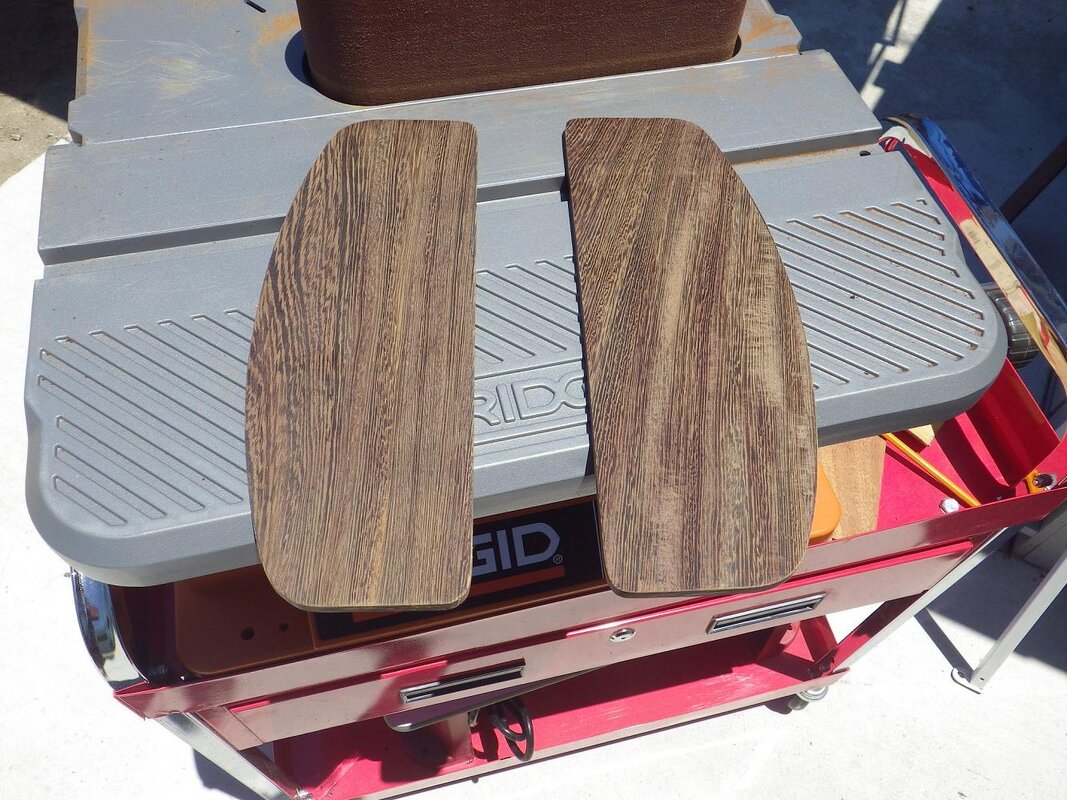

I found this beautiful sliver of WENGE wood (1/4" thick by 5+" wide x 7' long) at a local exotic wood supply and decided to try and make me some custom real wooden floor boards.
Once I get them finished, I just have to figure out how to mount the boards to the floor board base, with some sort of rubber isolator in between.

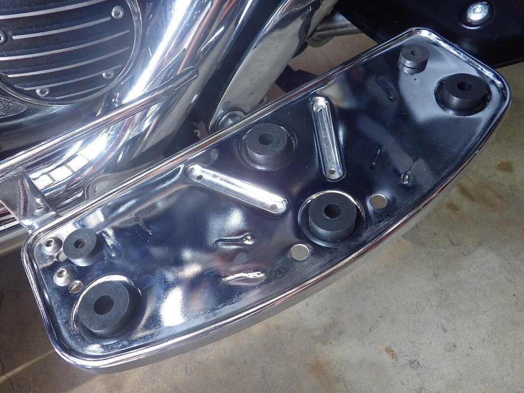

If you would like some rubber isolators that will fit perfectly, just send me an email at Kevin@DKCustomProducts.com I will send you some to use on your boards, no cost.

Thank you for the heads up, and the very generous offer. I have been looking for rubber grommets to use as spacers/isolators between the base and the boards. Those sound like they 'wood' be perfect. I will email you as soon as I post this. Thanks

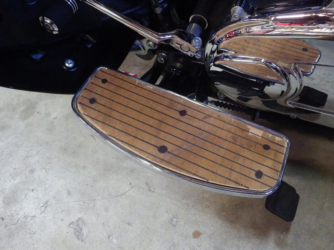

Originally I wanted to mount these with no visible screws or bolts. kind of like the stock boards are mounted, but these boards are so thin @ 1/4" that might not be possible or safe. So I think I will mount them with isolators and flathead bolts through the boards, spacers and base, and I made this mock up template (see pic) to see if I liked the look. The lines will be routed into the board (approx 3/32"deep) to add grip and channels for water to run off, just like on a boat. The two inner corner bolts will be fake (not bolted to the base) to balance out the look of the floorboard.
I also plan to put a few coats Helmsman Indoor/Outdoor SPAR URETHANE Clear Semi-Gloss with some Interlux Polymeric Nonskid Compound mixed in to give the boards a no slip surface.

Received your email, isolators are headed your way tomorrow.
Very cool! Def one of a kind!
Thank you very much Kevin, your generosity is MUCH appreciated.

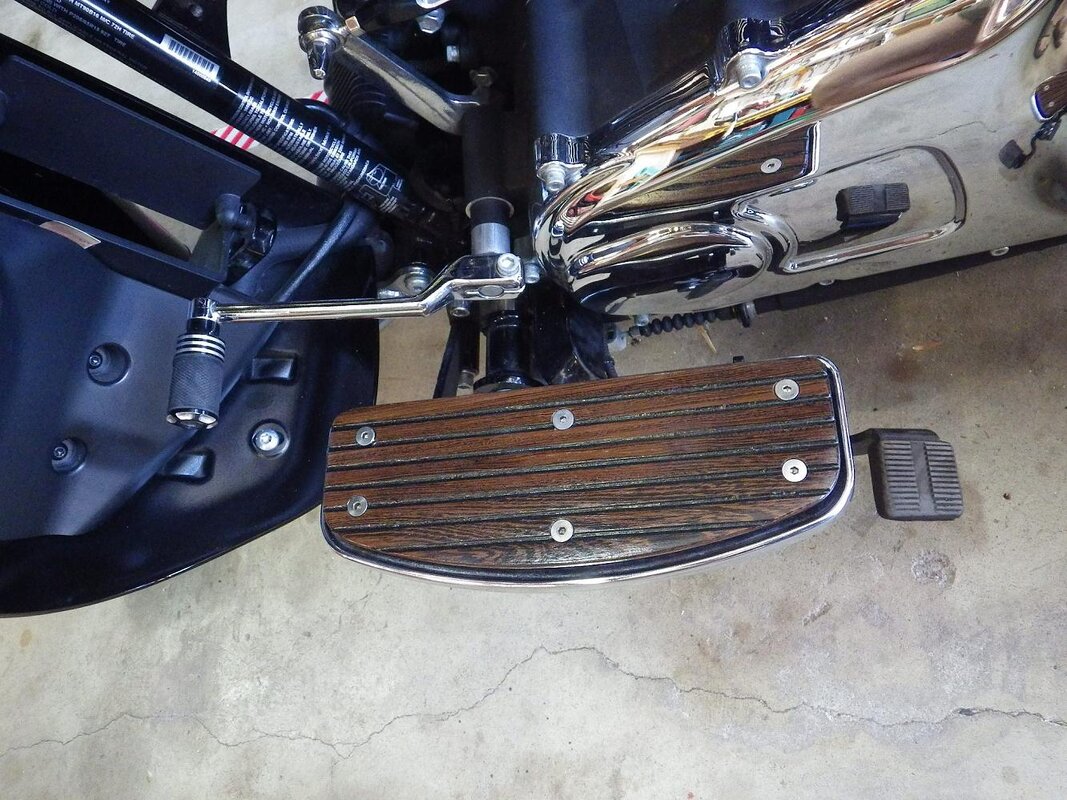

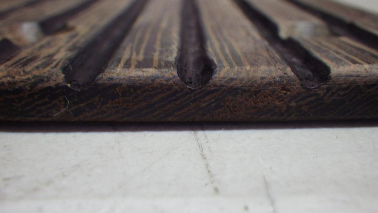

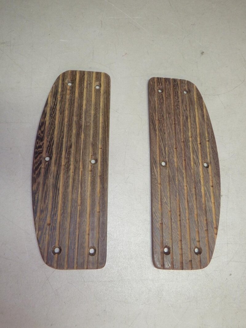

With that in mind :D I went ahead and drilled and countersunk the mounting holes, then routed in mock plank lines to aid in the grip, and there is still plenty of meat left in these 1/4" thick boards. Then I used magic marker (just for now) to see what they might look like.
Not bad :pepper: and I am sure they will look even better once I paint the lines with black paint, then get them both covered in a couple coats of Urethane.

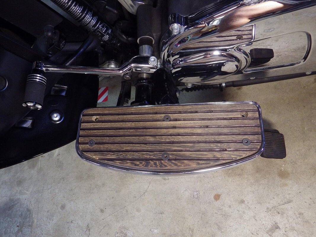

While waiting for the isolators I put two coats of black acrylic in the traction lines, let it dry overnight and then sanded any excess paint for nice and crisp edges. I won't know how long the bolts need to be until I get the isolators, but I did a mock up with blackhead bolts and stainless bolts.
I like both looks.
:Shrug: Next comes the Urethane.

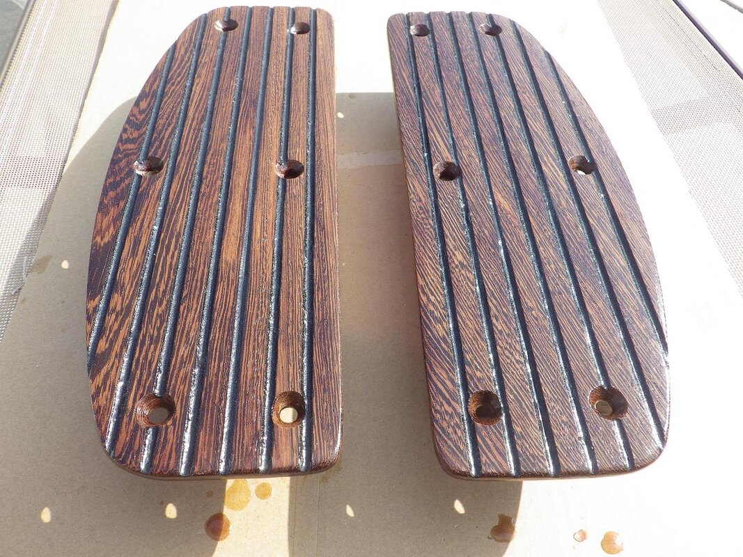

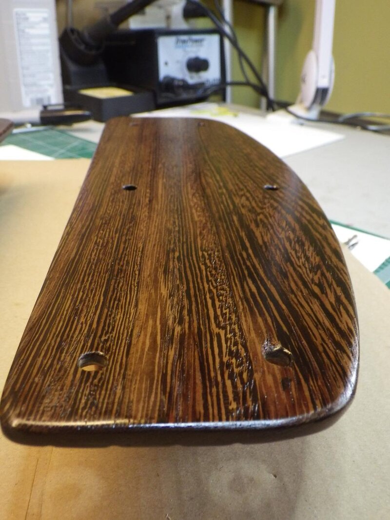

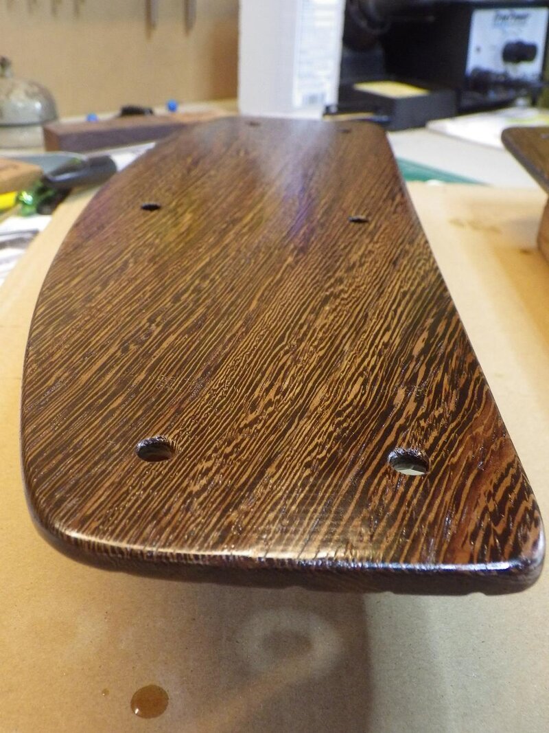

I got the underside protected with two coats of Urethane. Tomorrow I will flip them over and do the business side.

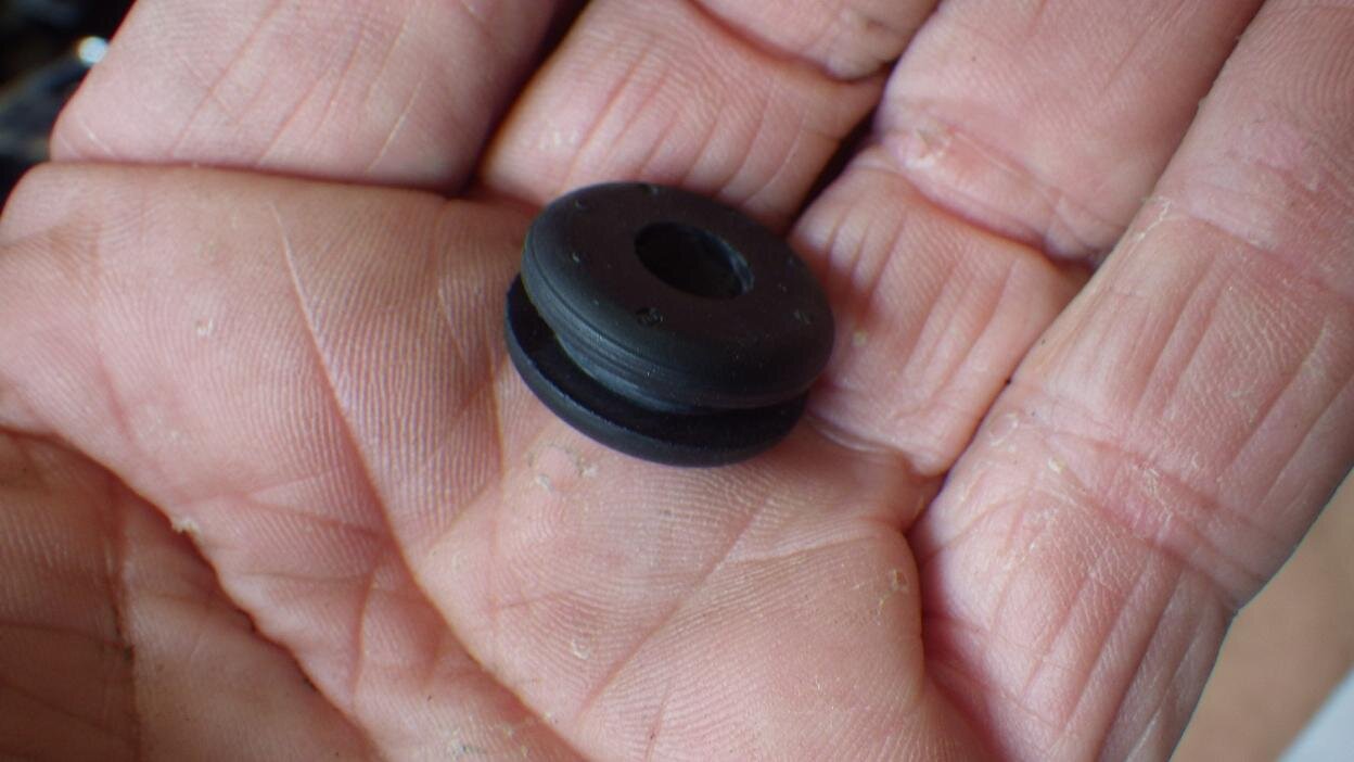

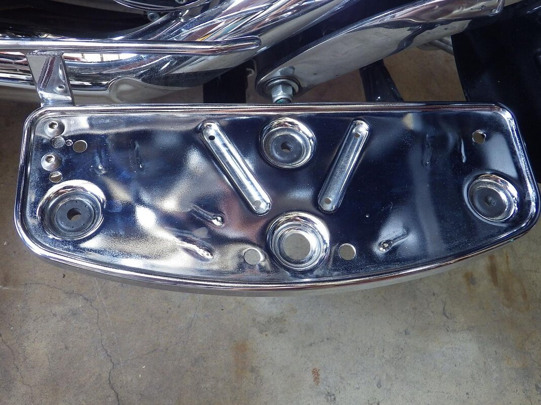

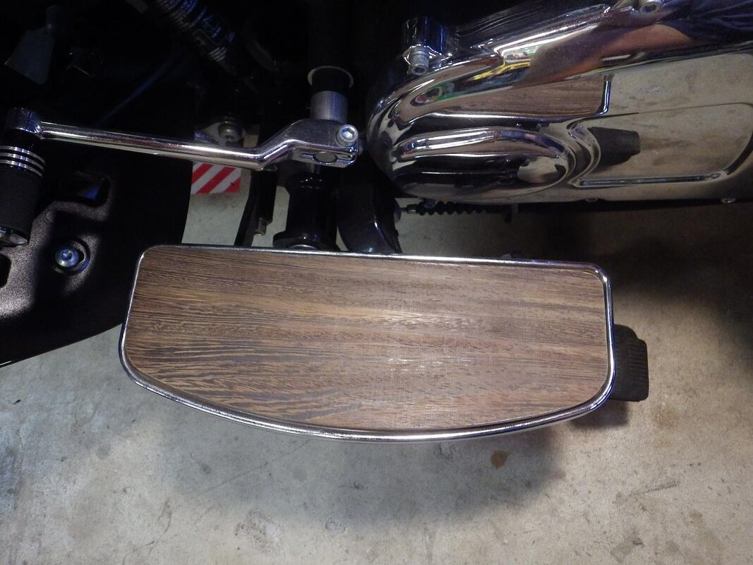

I got the boards sanded and then before putting on the top coat I decided to test fit them to the pans and drill the extra mounting holes.
I got the grommets that Kevin sent (Thanks they are PURRRRRFECT) and will also use some additional rubber spacers to get the boards high enough to allow the use of the re-located heal guard.
Next I will take them back apart and lay on the top coat and scratch coat
Looks awesome. Great handiwork PMBOXX3R! And you'll be the only one to have something like that ThumbUpThumbUpThumbUpThumbUpThumbUpThumbUpThumbUpThumbUpThumbUpThumbUpThumbUpThumbUpThumbUpThumbUp

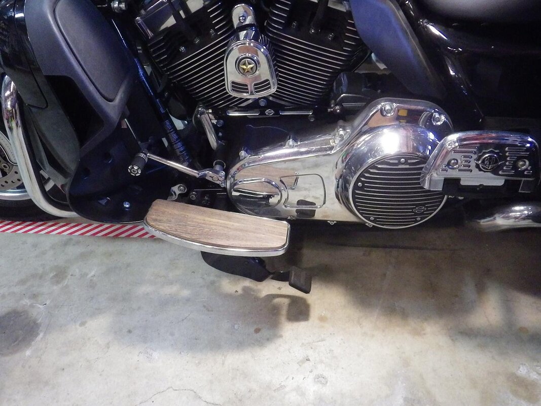

Morning Tease......

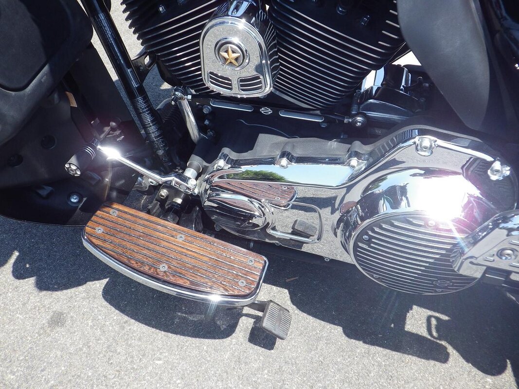

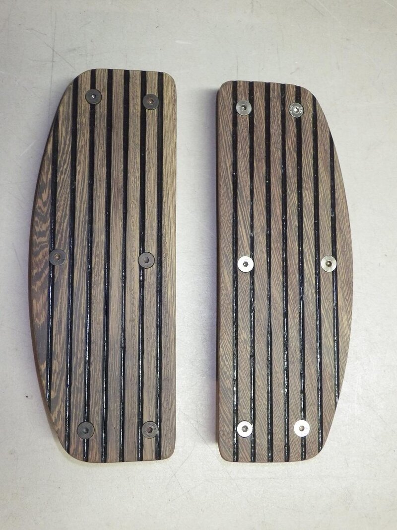

Before I mount these puppys I have them sitting in the sun for a few hours to warm them up and for the urethane to settle down. Not sure why, but it sounded like a good idea until I get motivated to finish the install.

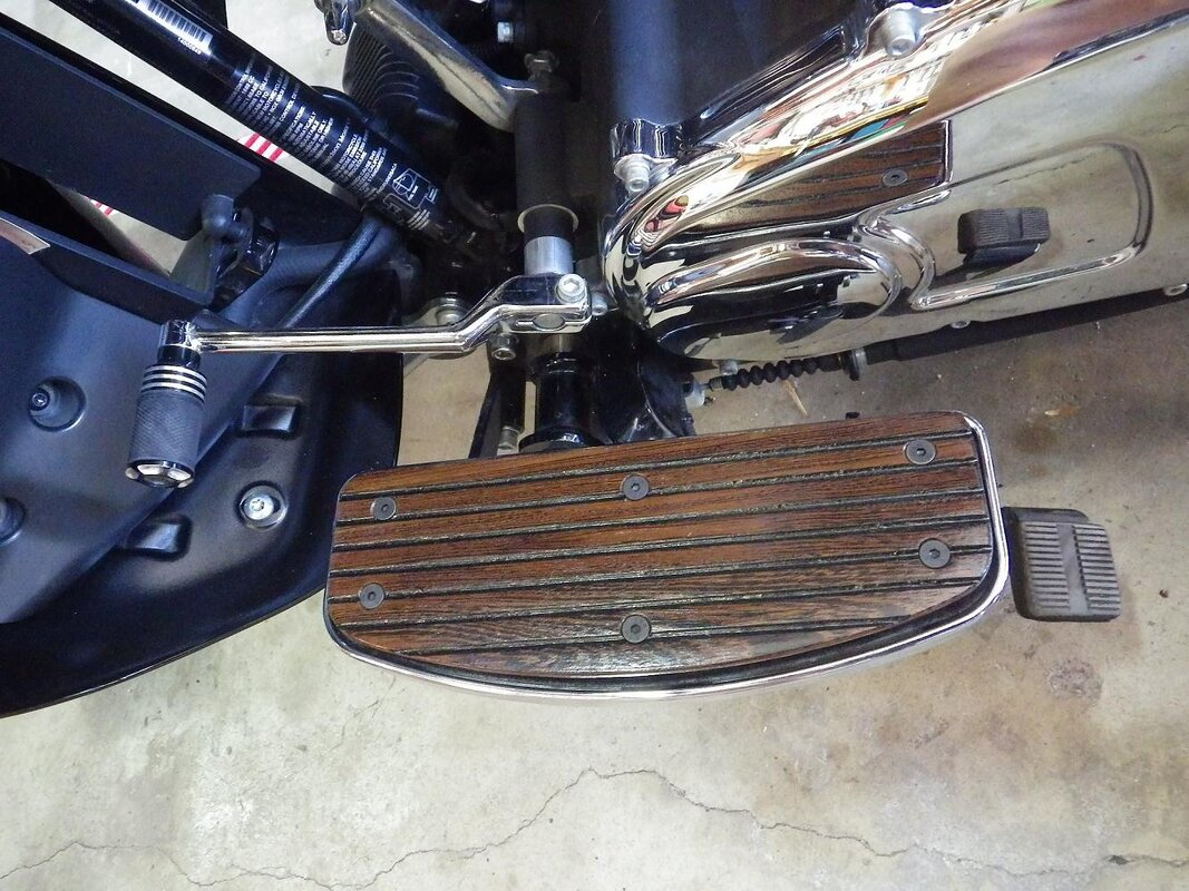

Decisions....decisions...

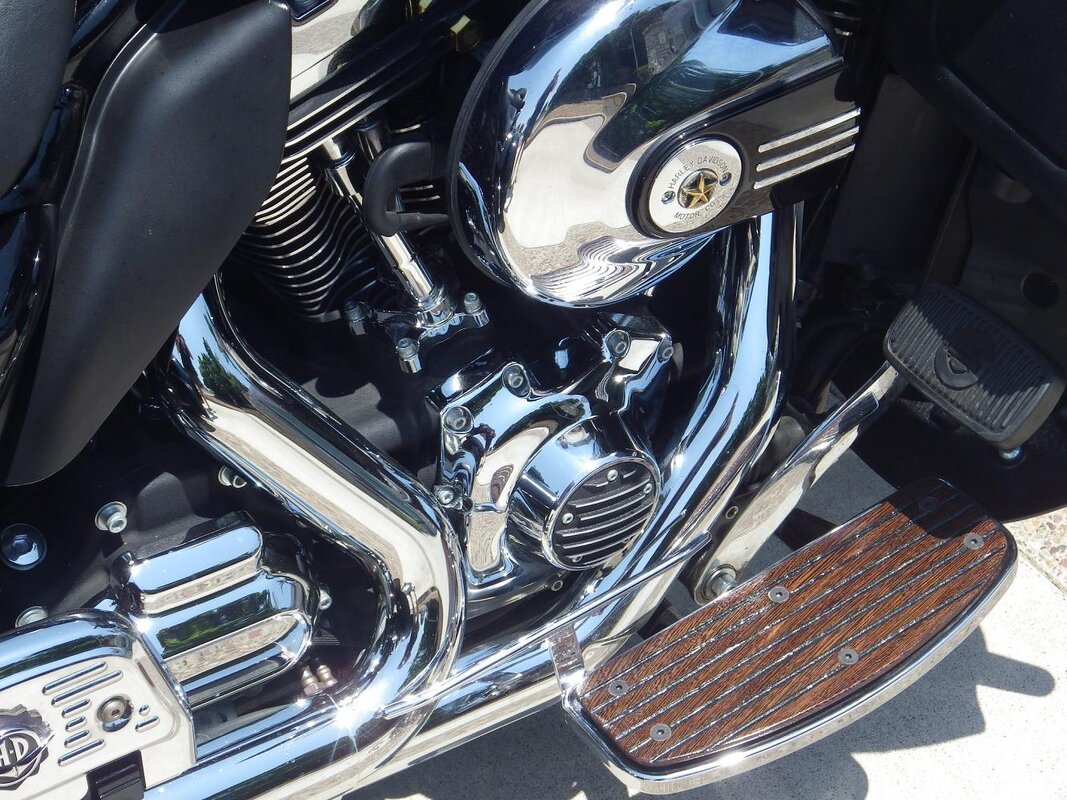

I thought I wanted black hardware. But I am now leaning towards the SS hardware to add to the 'contrast' look???
For now I am going with.....Black Bolts Matter, plus they are what I have. And I think Fuzzy is right, the SS bolts might draw attention away from the beauty of the wood.
I have ordered some 1/4" thinner rubber grommets/spacers to see if I can get the boards lower into/onto the pan. Once I get them I will make the final decision on bolts.

Those are great looking

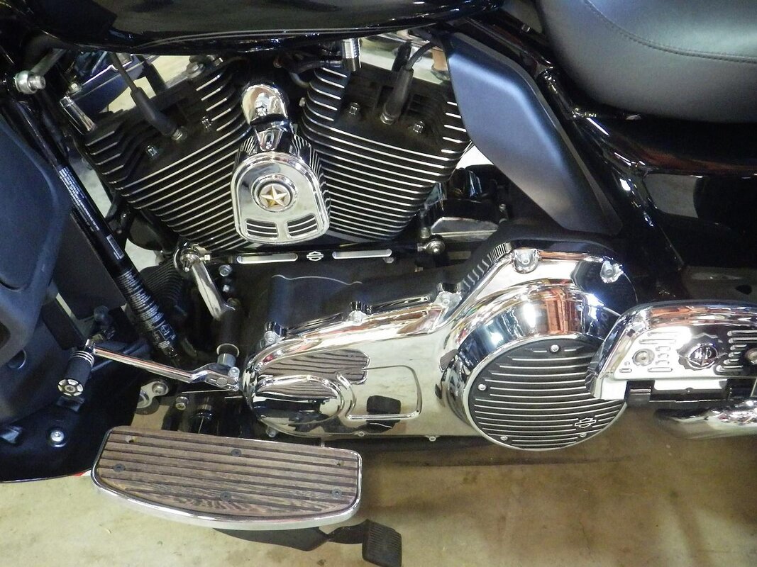

The spacing seems about the same as my HD isolator boards I have on old Shiney ride safely fearless
Black is always beautiful, but that SS looks REALLY good...especially with the rest of the chrome on your bike.
But frankly, BOTH styles look really good on a set of handmade boards ThumbUpThumbUpThumbUpThumbUpThumbUpThumbUpThumbUp
