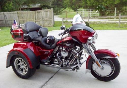

I have flat black vehicle body wrap material on my fenders. Took about two minutes per fender to install. It comes in eleven different colors. Installer said the reason it goes on so ease is there are tiny serrations on the sticky side allowing the air to escape during application. Has been on for over 15,000 miles and still looks new.

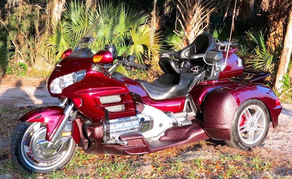

I removed my boards and the finished product exceeded my expectations. Had the Line-X colored matched. No regrets.
