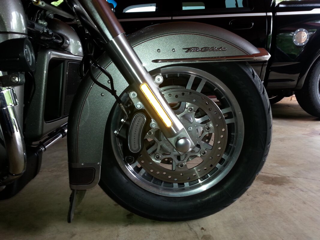

I don't think it will fit in the fender.

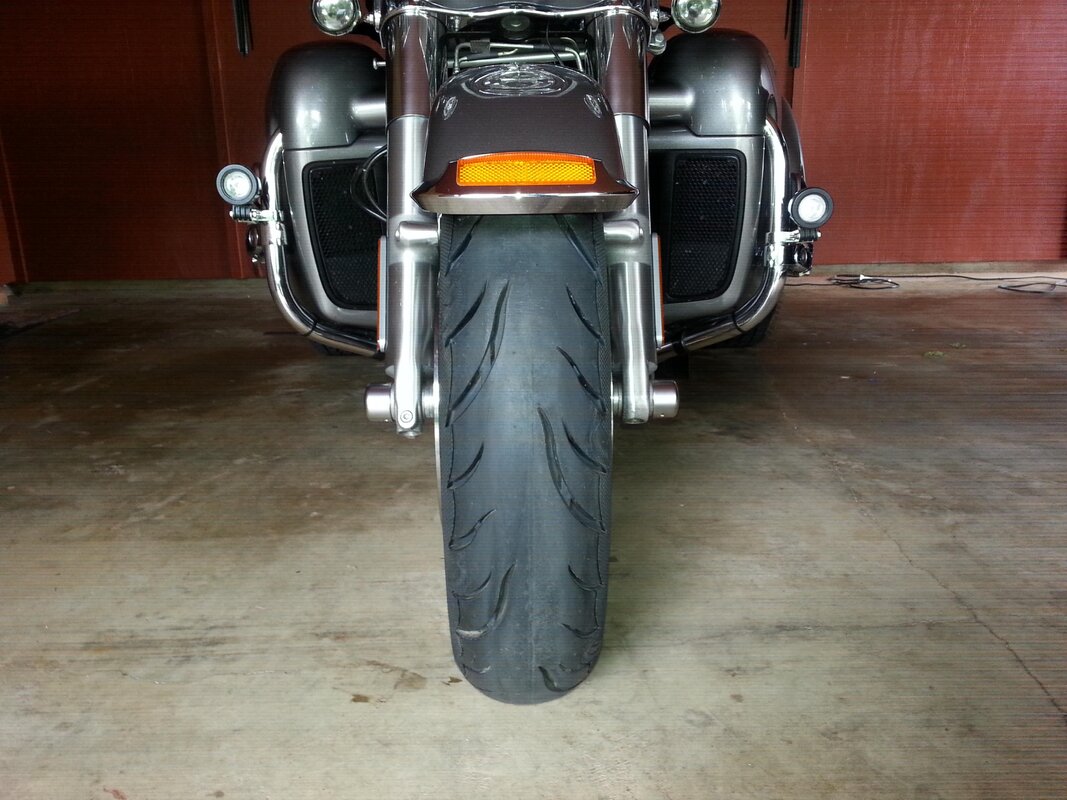

I ran a MT90B16 rear tire on the front of my Tri Glide....I think that is about 130mm.
It barely fit in the fender.
