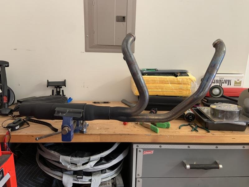

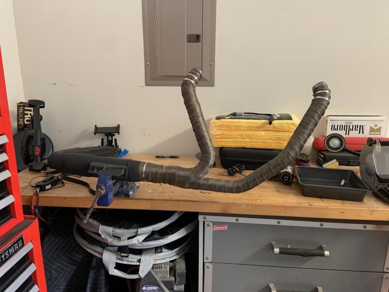

Than I wrapped the pipes with Design Engineering Titanium 2" Exhaust Heat Wrap. Since it was my first time wrapping exhaust, I was surprised how easy it was. Supposedly the wrap will reduce the heat by 50%. We will just have to see!

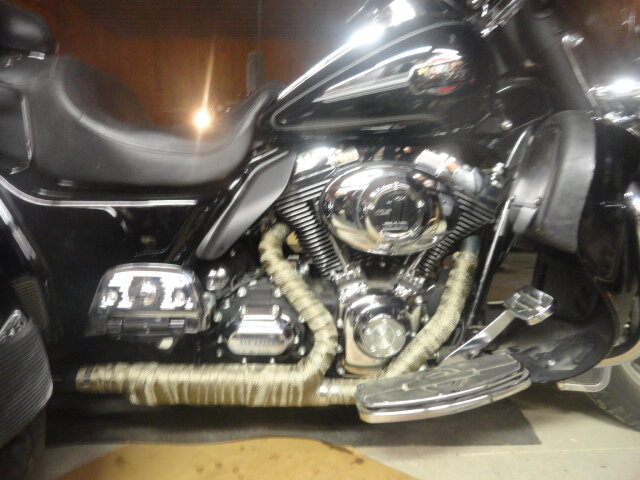

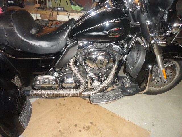

When I did the handlebars I also did the header pipe wrap with DEI titanium wrap. no spraying or soaking with a sealant. The wrap still is in great shape in six years. Granted I don't ride 10,000 miles a year but I can say it does really make a difference. There was an old guy around town when I was just a young Yamaha rider his name Red Conner an old Indian rider he would say if you young guys really want to help the rice burner run heat wrap those pipes, we all laughed young fools I guess. These are pictures before I put the shields back on. Wrapping the header pipe is just part of the heat management we have done for motor longevity and rider comfort.

I belive it was a 25 ft. Roll and I have a little left over. Back then it was a little pricey now the cost for the titanium wrap has come down. Also I used the slim roll type clamps seems they work well
